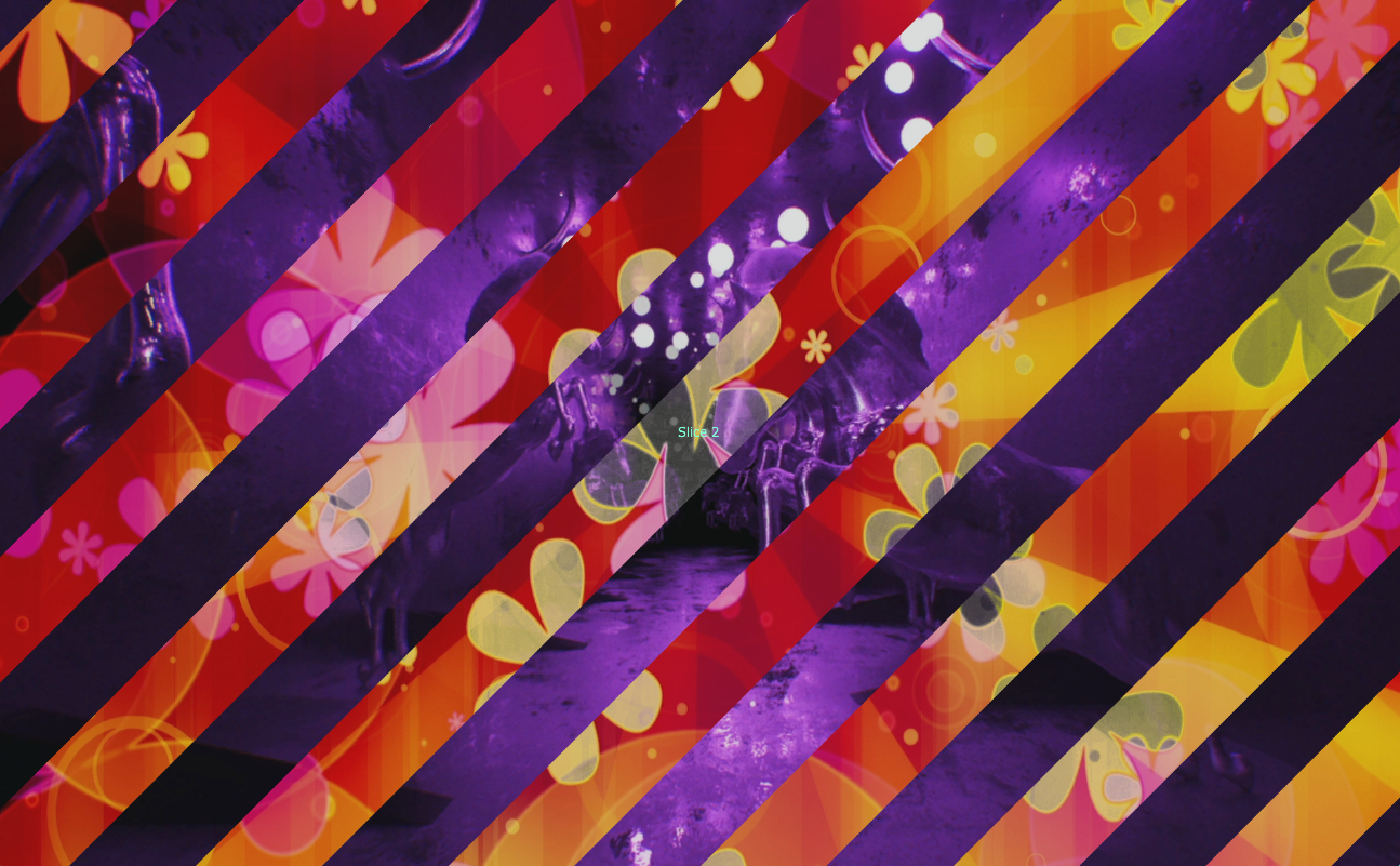

Hello again,

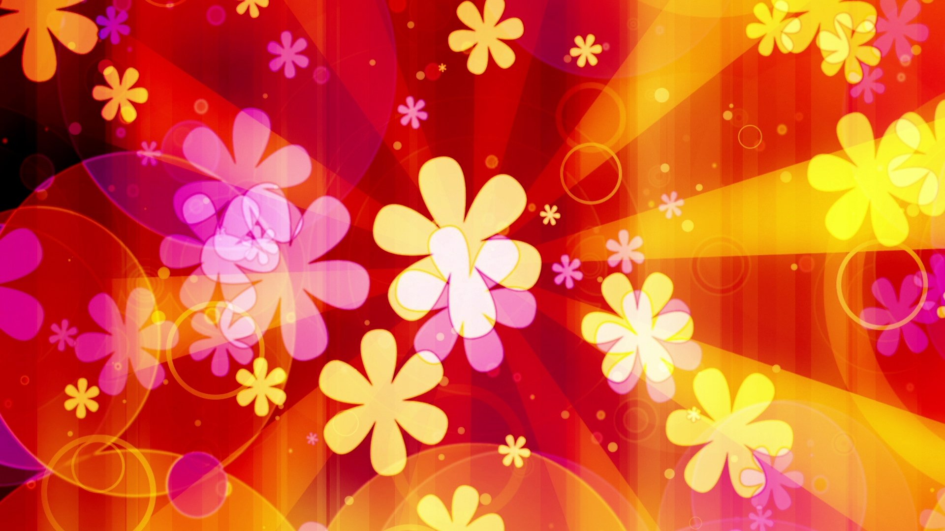

may I can ask you again to assist with this topic. Due to the Automask effect on the top layer 5 I've an issue especially for bright content (on layer 1, routed to layer 5).
I've used 2x the resolume demo footage ( C:\Program Files\Resolume Arena 6\media ) + a bright picture. For the bright picture I can see the background video even if I bring the auto mask contrast to 1.
I hope you are able to reproduce the behavior and help me to do it the right way :-)
Thanks
PS: In docoptics video you can see the difference between res5 and 6 at 2:20.
mask overlay.avc
(267.66 KiB) Downloaded 586 times
Re: Track mattes in Resolume (SOLUTION)
This track matte trick was nice in Res 5, when it wasn't possible any other way.
Now in 6, I'd recommend to use the layer mask mode instead: https://resolume.com/support/en/layers#mask-layer
