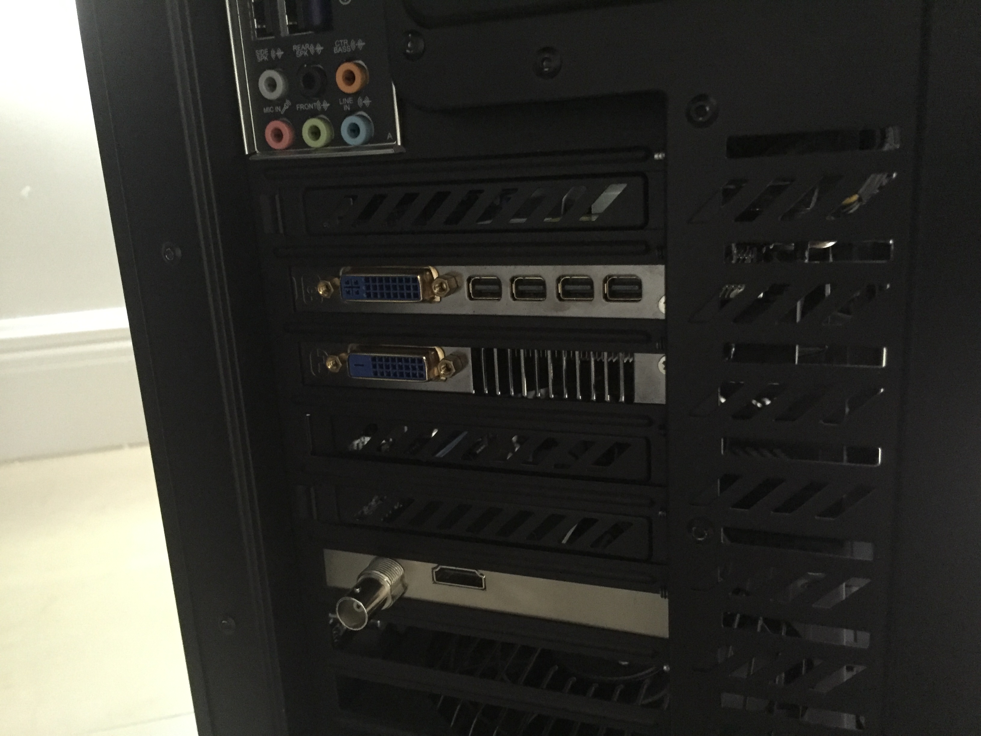

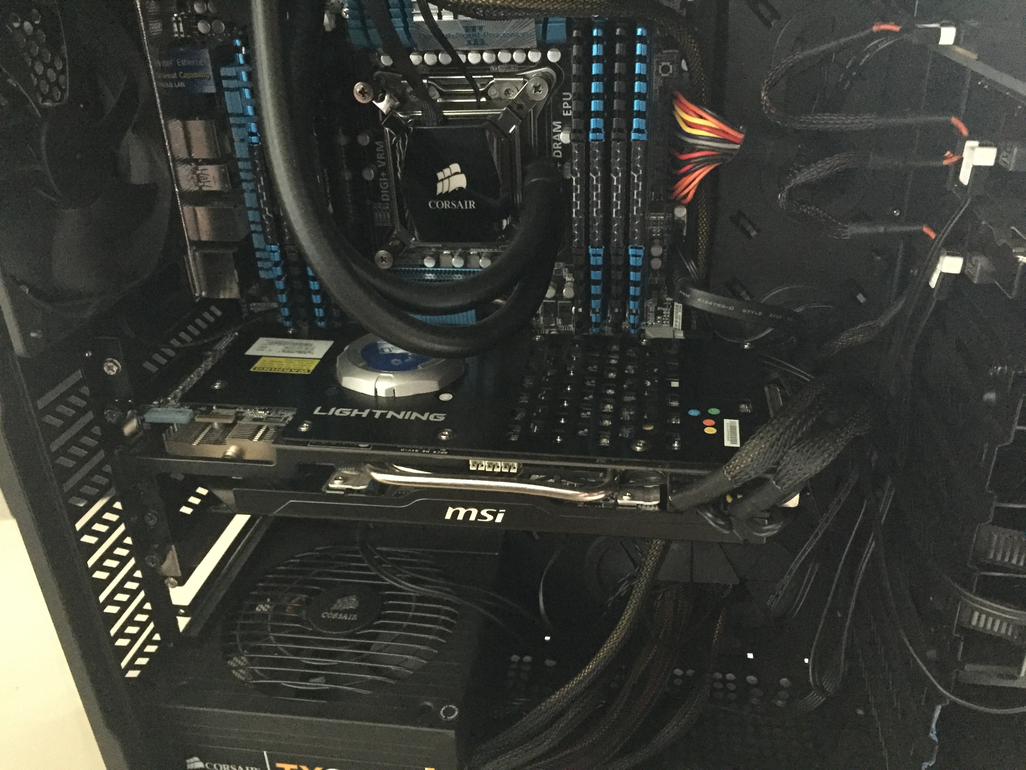

Thank you, Im not sure if its the same model. Here is one of my rigs. These cards have outperformed what was expected from them.
