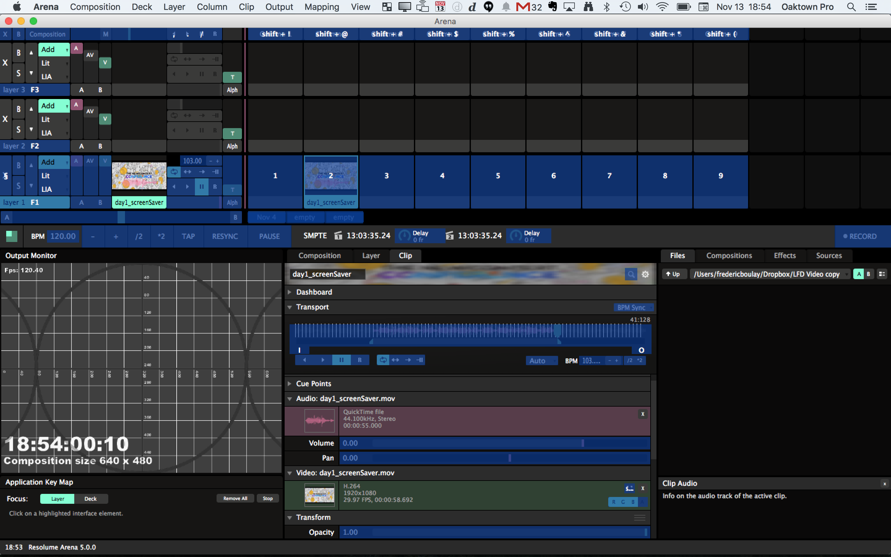

It would be nice to see what keys are mapped by default when mapping, or a warning that a key is already mapped to something else. It would help us new guys, but I will get up to speed fast.
The keys that are already mapped show in Edit Application Key Maps and I don't think there are any composition key pre-mapped.
