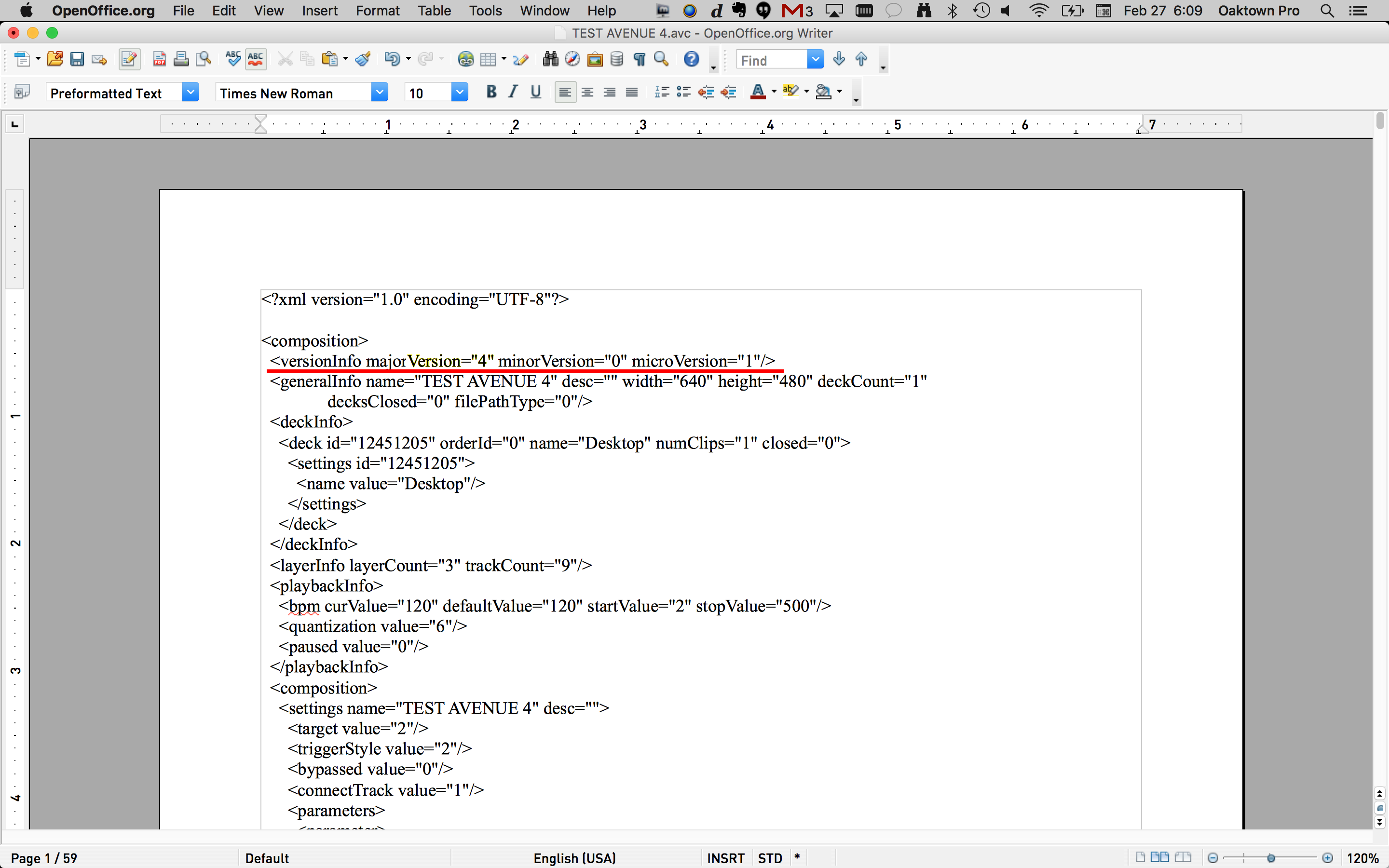

Arena 4 and avenue 4 compositions should open fine in the other, you'll need to manually edit the arena 5 comp to be able to open in v4 serach for the first MajorVersion value and change it from 5 to 4.
You may lose some settings or functions.
Re: Animator new to VJ, Halp!
To change the version, open the AVC file with an xml editor. Here is where you'll find the information in the file and what you need to change to open an Arena 5 file with Avenue 4 (I used openoffice.org to edit the XML file in the photos below):
After you save it with Avenue, the XML file will be changed to your version of Avenue 4 (In this example Avenue 4.5.1)
and of course all the functionality specific to Arena 5 (timecode, DMX, Artnet, advanced mapping, etc...) will not be available
Oh awesome! I'll get good use out of this! Thanks a bunch man for the detailed info. I have both versions but someone else has the machine with arena on it and I needed to make a render using avenue. xD
