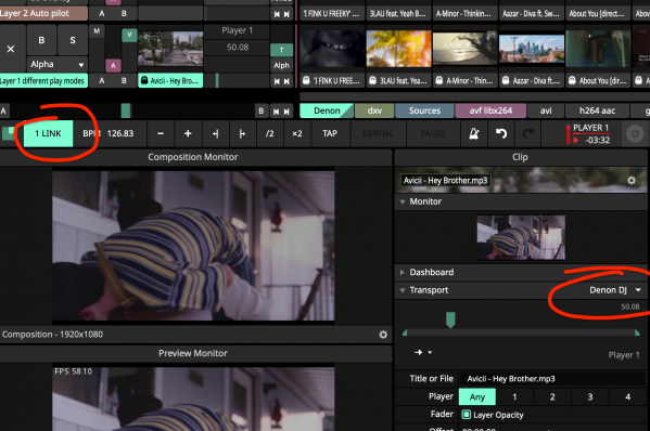

LockedUpCash wrote: Wed Feb 23, 2022 14:52 This is true, however when switching the mode of bpm to LINK you lose the denon fader control over the clips and it still doesn’t resolve the non auto looping feature. I’d have to use a separate midi controller to have any control over arena.
I don't mean the clip transport, I mean composition tempo. With that you can have parameters animated to BPM synced to your Denon's tempo. This would work well with generative sources, which can then be triggered with having them set to a Denon track, but their params would move on the tempo.
Denon sync indeed needs some preparation.
With random footage clips to random tracks, I think you are looking for a feature which doesn't exist yet.
The Feature Requests forum section is a great place to post those.

I have done what are describing before. Ex: animating the zoom of a clip with the LINK bpm set to the denon track. My main issue with that work flow is that when I set the composition tempo to LINK it seems to cancel out the Denon control over the tracks, like the fader controls you see on the right disappear. If the fader control at least stayed there I would reconsider using resolume more. If there is a way to achieve this I would be glad to be informed, I can’t seem to find a whole lot of info on these topics.
Posts: 7765
Re: RESOLVED: Denon Prime and short video loops
Like this woks just fine for me

Okay I set my gear up and it’s showing up this time :idea: . I guess I had some glitch earlier when I tried it. I’ll have to experiment with this but I think this will work. Thank you so much for the responses all day. I’m gonna test this out.
Posts: 7765
Great to hear it works now!
