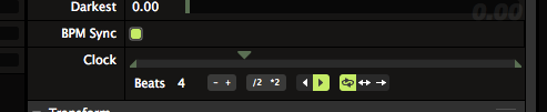

Gave FRMultiStrobe a whirl, and BPM Sync works fine.
You just need to animate the Clock parameter with BPM Sync. That's how the plugin knows what the BPM is doing.
Re: Strobe effect - so basic, still not quite there?
It doesn't work for me unless I also match the interval to the beats (for strobing on the beat). Use the Interval number on the right that goes from 1 to 10 rather than the slider value. So 4 beats would need an interval of 4. If you have 4 beats with an interval of 2 it will strobe every second beat. Quite flexible really and if you adjust the in and out you can add a bit of swing to the flashing.
