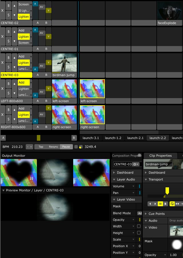

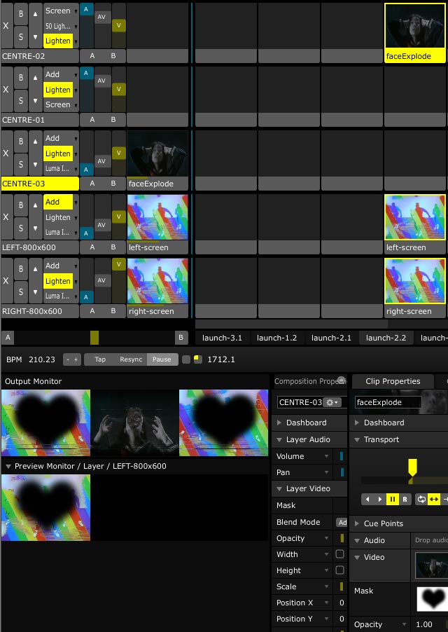

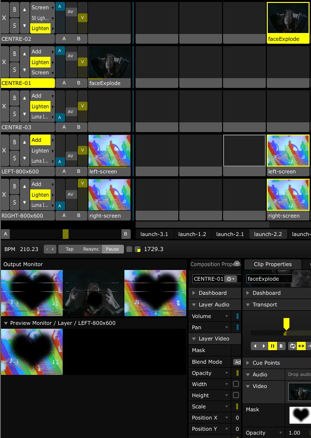

See following pics for examples of what's happening (the same clip is triggered each time in a different layer to the same output).
1. Clip displays but the mask doesn't
2. Clip displays but it's the wrong mask.
3. Clip doesn't display at all
4. Different clip triggered on the same layer as 1. where everything works as expected. This clip originally had the same issues but I deleted and reapplied a mask.
Also, while I was making these screen shots, I noticed that if the centre clip isn't triggered at all, the masks in the left and right clips decrease in size. This actually seems to be the intended size but the difference is subtle and I hadn't noticed it before.
Left: without the centre clip triggered; Right: with the centre clip triggered
