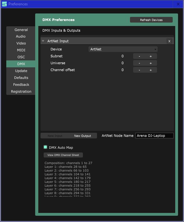

To add, here were the Resolume settings during that test.

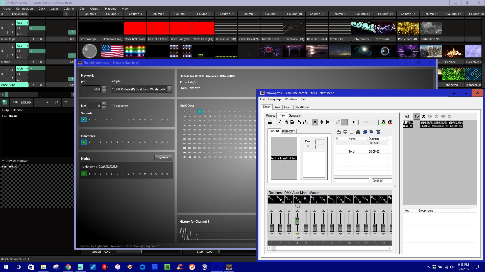

I did change the Fixture address in ShowExpress to my new 10.0.0.95 as well as 127.0.0.1. Neither option worked for me yet. When I used the ArtNetominator (great tool, thank you) I see activity on all the right spots. It is good to see that SX is sending exactly what I expected it to. But this leaves me with more questions about why Resolume is not responding at all to the commands that are clearly being sent.

I did use the ArtNetominator, screen shot is above. SX is working and sending exactly the way I expect it to. So you are probably right, SX is probably trying to take exclusive control of the port. So Resolume can't use it at all.
