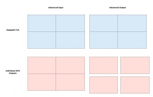

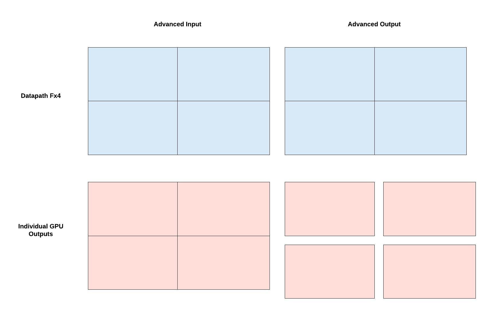

Yes, edge blending does work with Datapath. But what about warping? If you warp, you will need to stay withing the boundaries of the quadrant you are working on.
Re: NVIDIA NVS 810 for new system
That would always be the case regardless of how you distribute your signal.But what about warping? If you warp, you will need to stay withing the boundaries of the quadrant you are working on.
See this image. When you have individual outputs, they are singular on the Advanced Output. Meaning each has it's own mesh warping, no?
Mesh wraping is for slices, you can have many slices on one screen, each with individual wraping.massta wrote: Wed Jan 08, 2020 17:55 When you have individual outputs, they are singular on the Advanced Output. Meaning each has it's own mesh warping, no?
