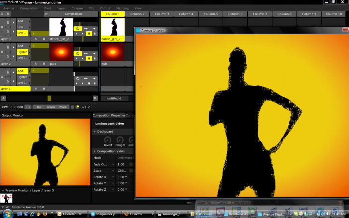

There are some weird bug on the layer opacity.. When I fade it down, the video still remain on the output. I think it does only when using lumakey and chromakey.. but Im not sure.

I have just tried all mixers just to be sure and I found that Wipe Down shows a 1 pixel line when mixed all the way down but I have not found any other problem. Let us know when you can reproduce it.Luminescent drive wrote:There are some weird bug on the layer opacity.. When I fade it down, the video still remain on the output. I think it does only when using lumakey and chromakey.. but Im not sure.

I've attached screencapture with the bug... Layer 3 opacity is down.. so the layer should appear as off.

Make sure DXV codec is installed in default location (see earlier in this thread I think)Luminescent drive wrote:I've attached screencapture with the bug... Layer 3 opacity is down.. so the layer should appear as off.
