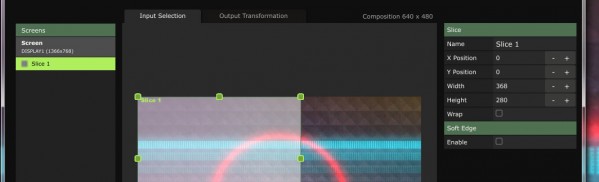

I am facing an issue in the Advanced Output too. For some strange reason in the INPUT SELECTION window, in Slice, there is no option that allows me to select the Input Source, as is shown in the video. Could someone help me out here??
Have attached a screenshot of what options are available. How do i get the Input Source option?!
Re: Advanced Output
This was added in Resolume 4.1. Please update to the latest version.
