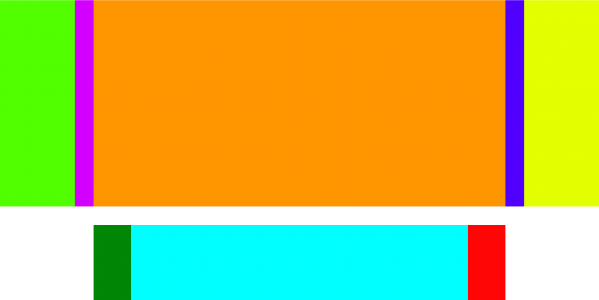

Also, considering the size of your outputs, I'm puzzled by your composition size. Why 3072x1536? How do you break that down in your advanced output menu to fit on your three show outputs?

Also, to answer your question about the maps... They're going out to three completely different LED Walls that use different processing for each one. So... 3 discreet outputs are needed (plus one for the interface). The mapping took all of 90 seconds. Very simple. It's just doing some really terrible things visibly. For reference, I've attached the screen map. Basically, the Orange part in the middle is one signal. The left and right of that are in another signal. Then the bottom is the 3rd signal.
