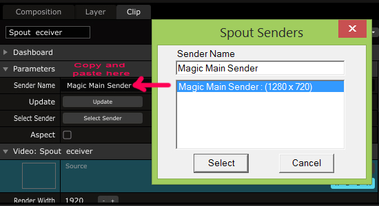

So, the awesome folks at Spout worked this out...
Basically, unless you type in "[Sender name from Spout Panel when you hit 'select sender']"
in the 'Sender Name' box (right above 'update' and 'select sender') it will drop ALL the sources
every time you switch decks and come back again.
Good news- Spout V2 won't do this, they say.
There you are- don't be a dope like me :-)

Here's a screenshot:
Spout problem.jpg (102.81 KiB) Viewed 4474 times
