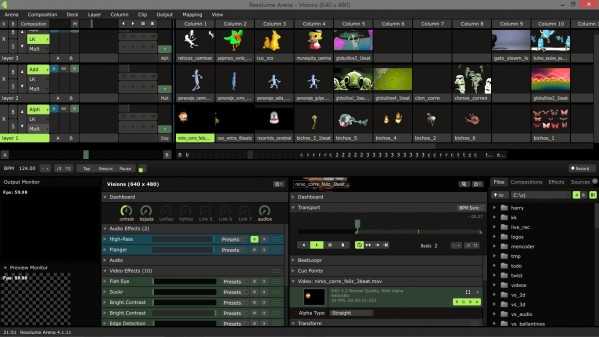

I use a lot of very short clips in my composition. I had to put them into small decks in order to reduce the switching time between them. Now I have 54 decks, and interface of switching them is weird! look that at right there is free space for some additional tabs... A workaround of a scroll bar or group them by pages would be very usefull... Look at the screenshot:

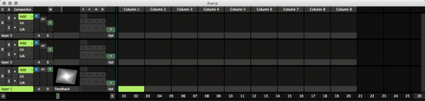

If I number my decks 01, 02, 03.....I can legibly fit 26 decks on my MacBook Pro which gets you almost half way there. Note that if you number 1, 2, 3, etc... you won't be able to see as many!

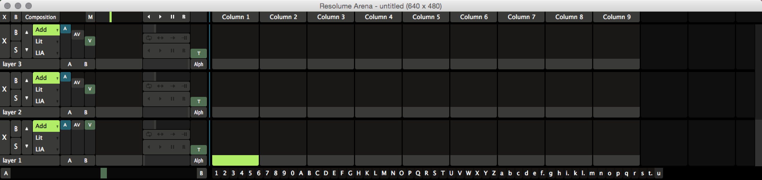

But if I label my decks 1, 2 ,3 .... A, B C, D, ...... a, b, c, d...., u I can legibly fit 56 decks on my MBP and it's pretty easy to select decks.
