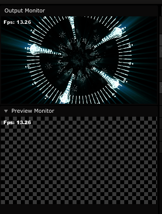

Attached a screenshot of the output monitor
- Attachments
- Output Monitor.PNG (109.16 KiB) Viewed 8629 times

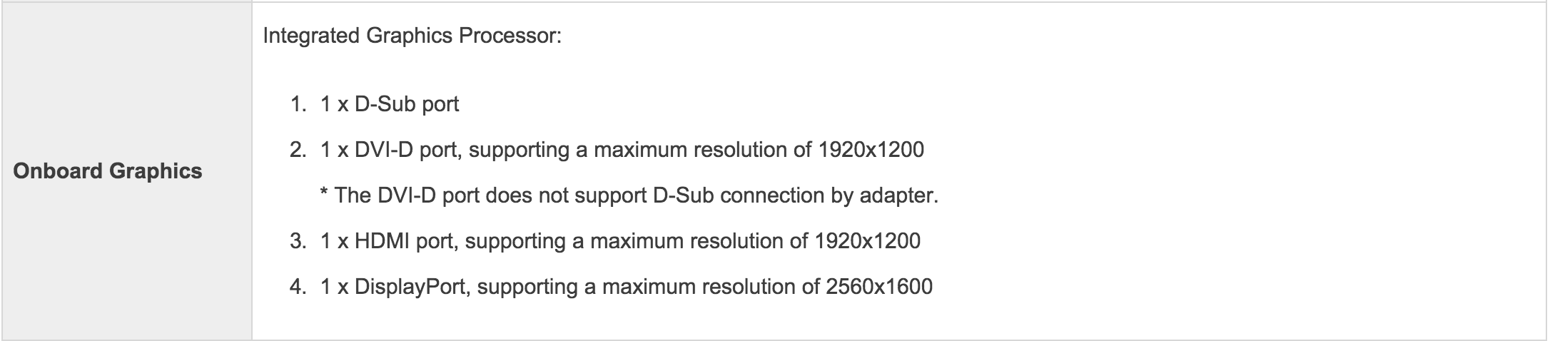

in preferences, feedback, there is a button to view log.
that motherboard has on-board graphic, right?
Re: Slow FPS on a Windows-Machine (1080p)
That MB does have onboard graphics

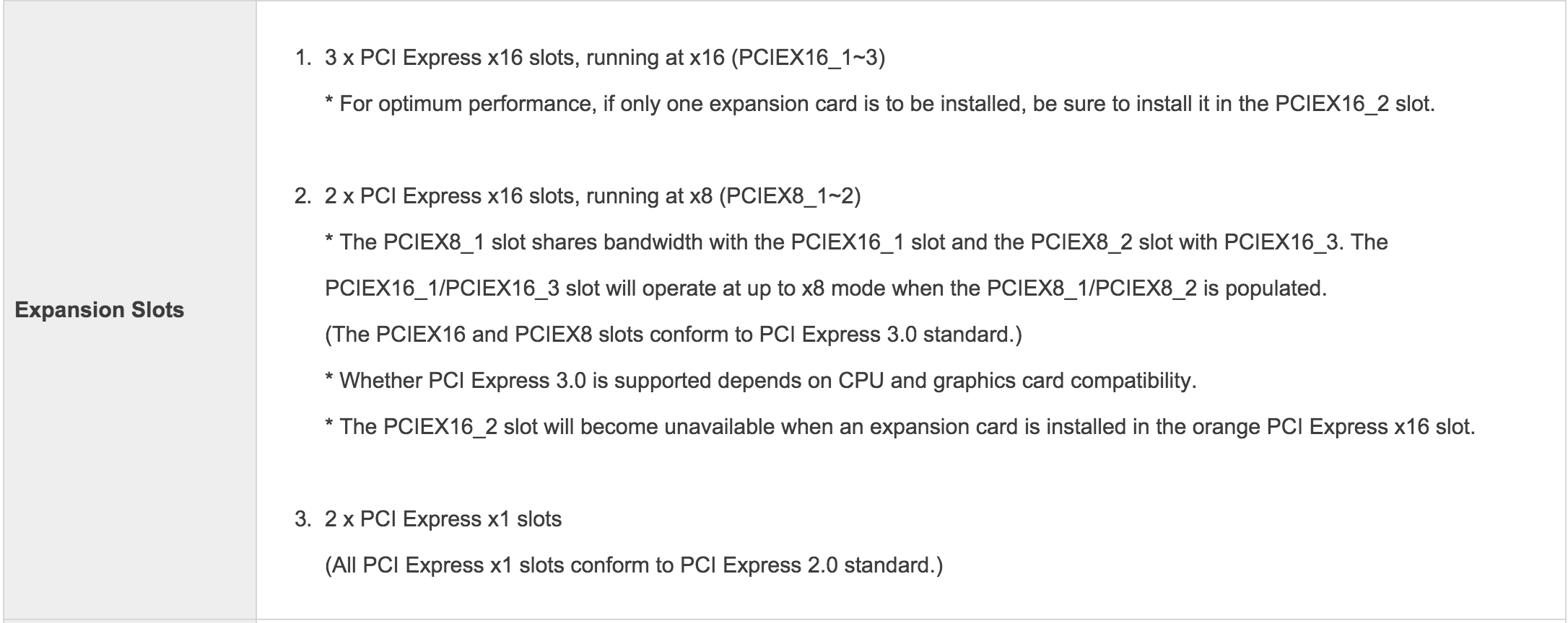

So make sure you connect everything you are using with Resolume to your Nvidia GPU including your control monitor.
Also it appears that only 3 of the 4 orange PCIe slots run at X16 and both X16_1 & X16_3 share their lanes with the two X8 slots so make sure you Nvidia GPU is plugged in X16_2 to get best performance.

Is your GPU in the second lane? If not, and you have other PCIe devices cards, it might not work at full speed.
