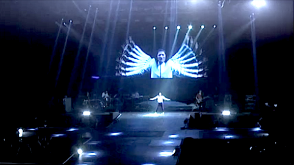

One of the aspects that made us choose Arena towards other more "prestigious" media servers, is that through FFGL we could develop our own plugins. In fact, also in the previous tour, Elisa's "L'Anima Vola" we created some plugins to make a choreography of the singer moving on stage, while on the screens her movements were repeated several times to create a trail.
Elisa tour 2014

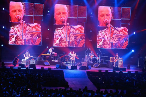

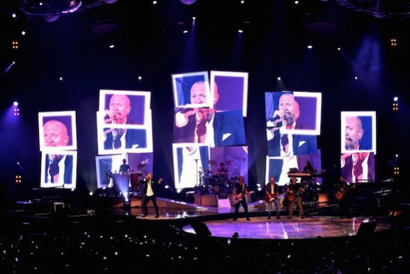

Another plugin I enjoy, which has been developed together with Davide Mania (an FFGL programmer I have been working with for years) we named ScrumblePict. I often use it, and it allows us to have copies of the signals without having to use more of Arena's clip slots . These copies can be moved, rotated, scaled and cropped, allowing to always create different templates.
Elisa tour 2014
Biagio Antonacci tour 2014

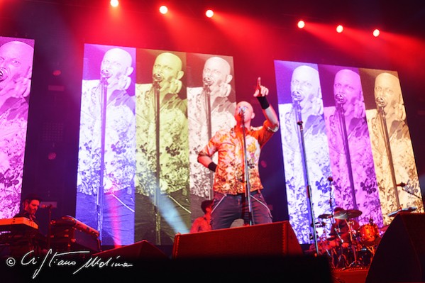

As I mentioned, I very much enjoy working with image decompositions, so in this tour we also got busy with breakdowns and recomposing the signal that came through the switcher.
Negrita live, example of the ScrumblePict effect.

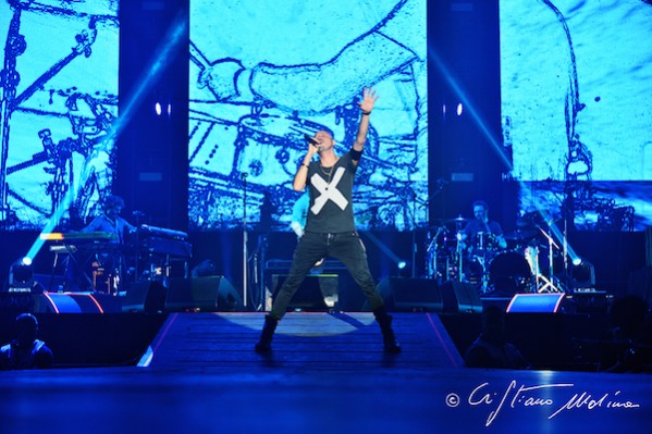

For other tracks, we took advantage of the edge detection and pixel screen effects.

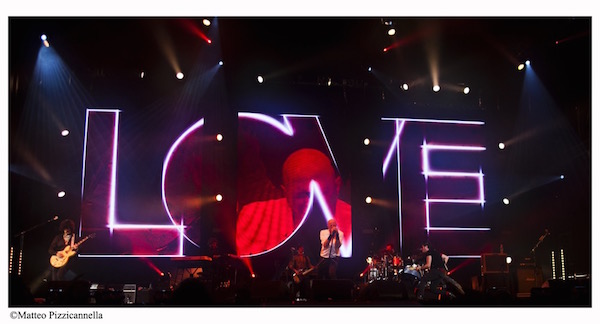

Another fantastic aspect of Arena is the possibility to use DXV files with the alpha channel. In this way we can create moving masks for live inputs.
Negrita live, mask with alpha channel and live inside
