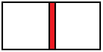

Red is overlap zone of two slices, when they turn softedge on, it works like on the photo in first post.
I can't reproduce this issue by myself. I only know that they using vistual outputs.
Looks like resolume takes top of image (which height is size of overlap zone), makes it softedge, and glue it to the bottom of slice.

Looks like the slice's input is moved to extend outside of the comp. So it wraps around and starts to blend with itself.
You can tell because the top of the circle appears at the bottom again.

Joris wrote:Looks like the slice's input is moved to extend outside of the comp. So it wraps around and starts to blend with itself.
Looks like, setting slice input outside composition size and turning on soft edge is unexpected behavior. But I don't know why they do that.

When you move the slice outside the comp with softedging turned on, Resolume assumes you want to wrap around for a stitched projection.
