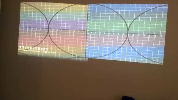

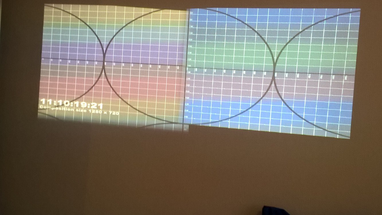

I don't know how to achieve this, but hear about it twice :shock: problem solves by restarting resolume.
Re: Strange soft edge issue
A picture's worth a thousand words, but what is the problem that I should be seeing? The blend being on the top and bottom of the left slice?

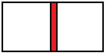

Red is overlap zone of two slices, when they turn softedge on, it works like on the photo in first post.
I can't reproduce this issue by myself. I only know that they using vistual outputs.
Looks like resolume takes top of image (which height is size of overlap zone), makes it softedge, and glue it to the bottom of slice.
Looks like the slice's input is moved to extend outside of the comp. So it wraps around and starts to blend with itself.
You can tell because the top of the circle appears at the bottom again.
