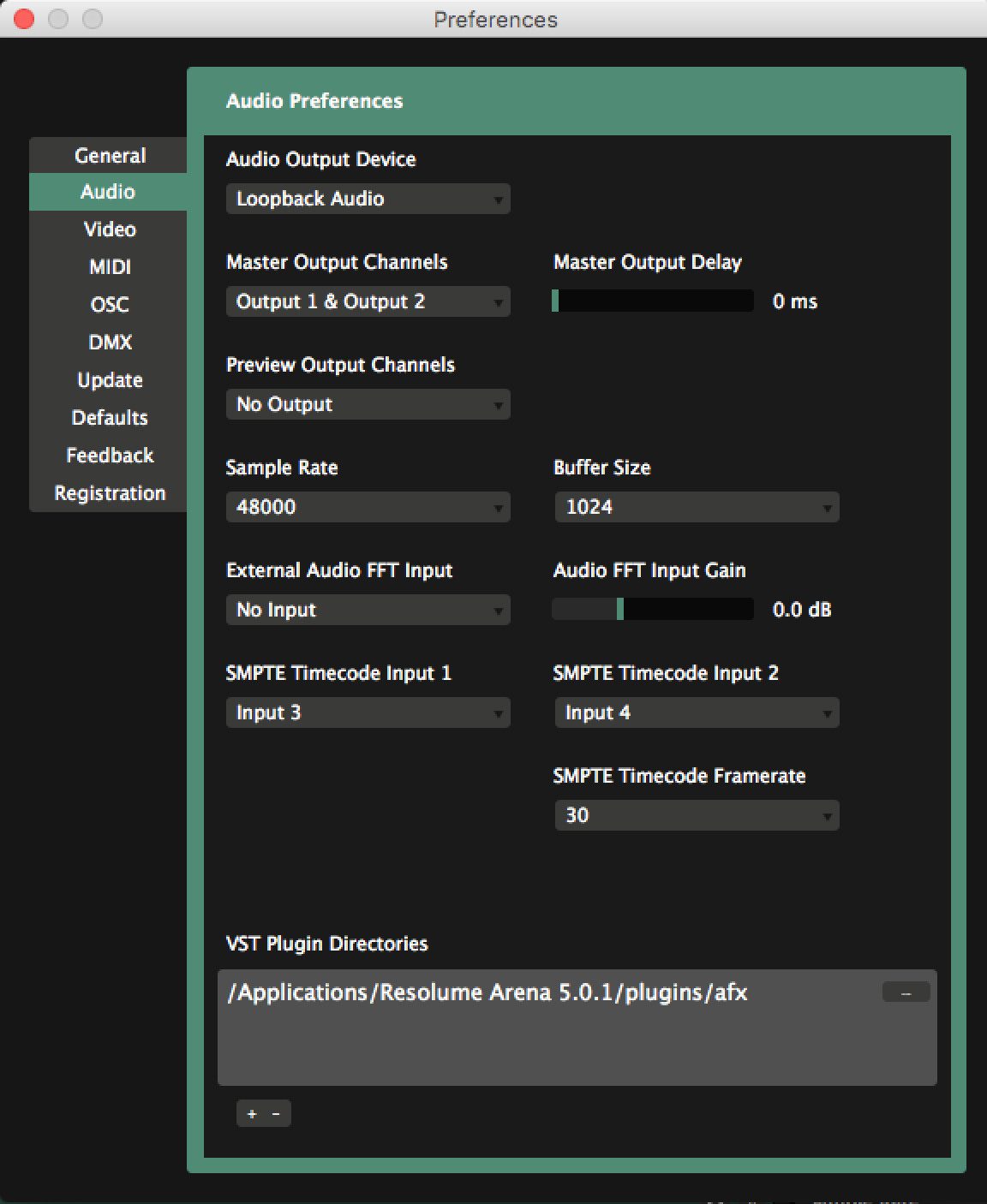

Arena can take two independent SMPTE timecodes
In Arena, choose channels 1 & 2 for audio input, channel 3 for SMPTE 1 and channel 4 for SMPTE 2

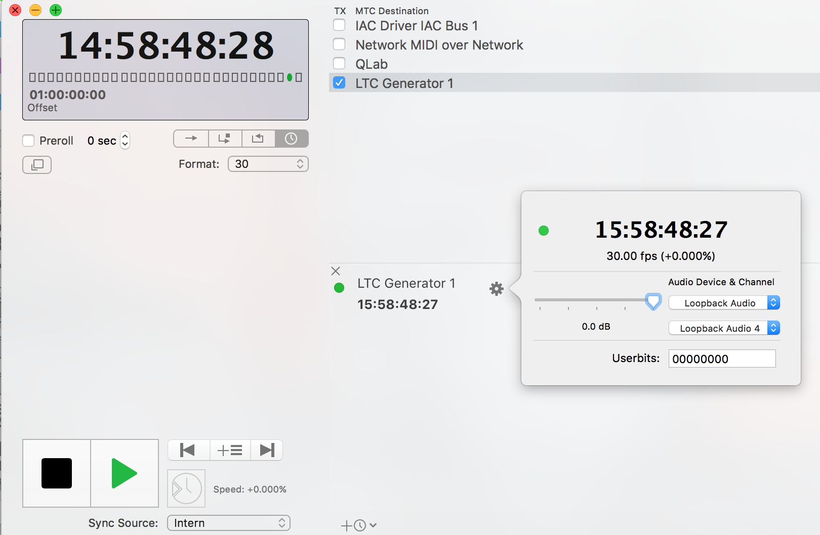

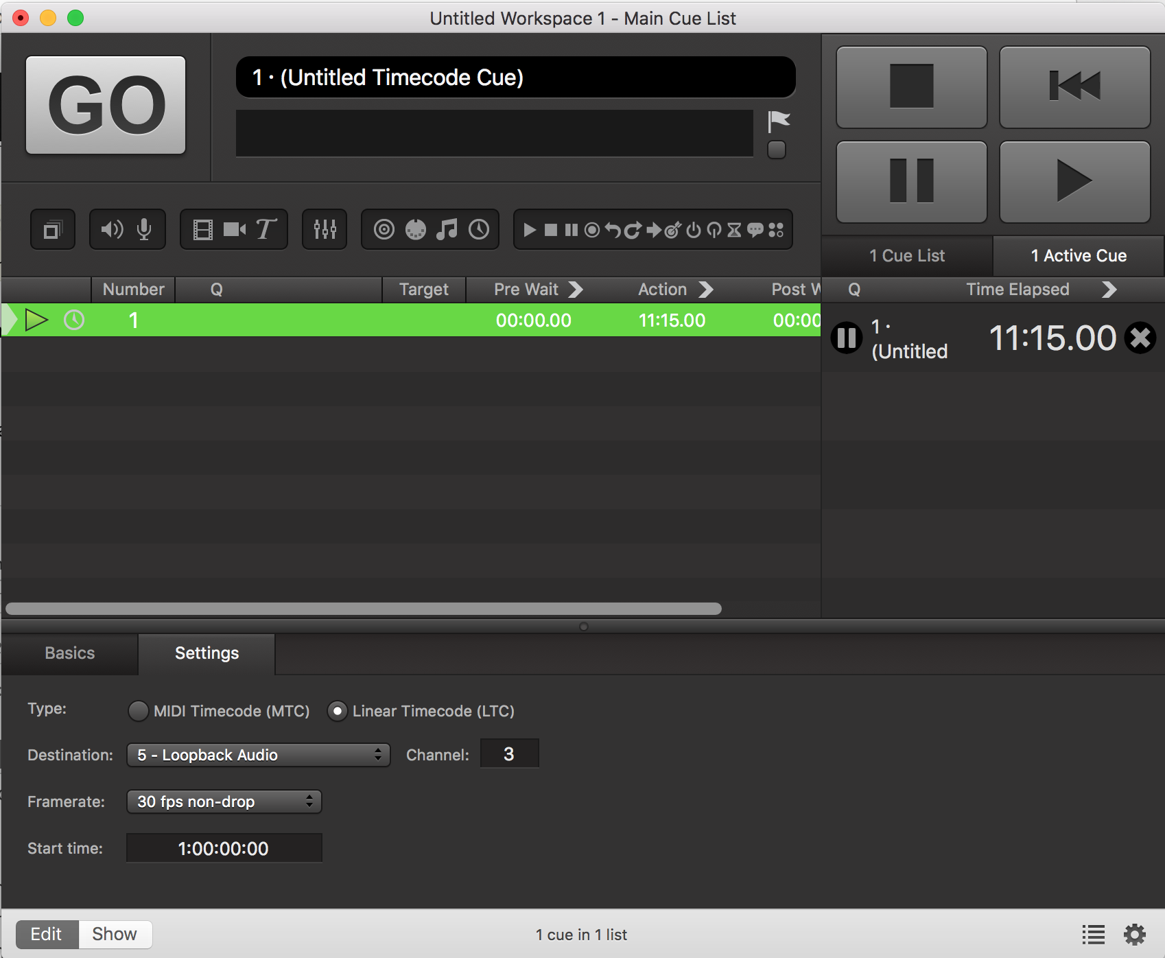

Horae and Qlab (pro audio or video) are both great timecode generator for the mac. As a note, Qlab can handle multiple streams of independent LTC and MTC timecode.
