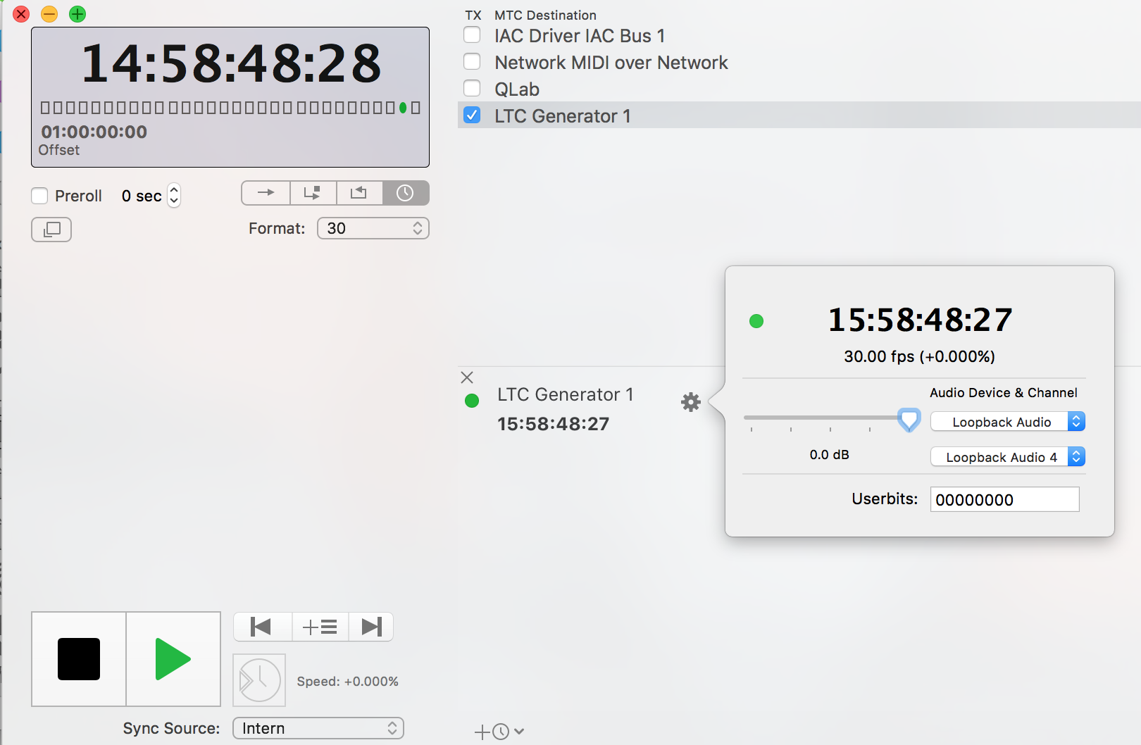

Soundflower and Loopback (from the same developer) both route audio from one application to another. As far as I am aware, iTunes doesn't send SMPTE Timecode. Would be better to use something else, maybe garage band or a DAW.
Re: How to get external audio input/SMPTE from an iTunes?

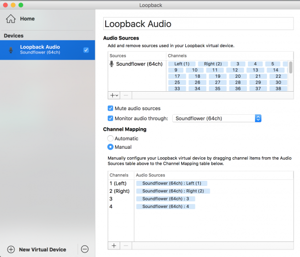

Use 4 channels of Loopback channel mapping table with Soundflower (64-ch) as follows:
Channels 1 & 2, assign main output L & R
Channels 3 & 4 assign your SMPTE source 1 & 2 )

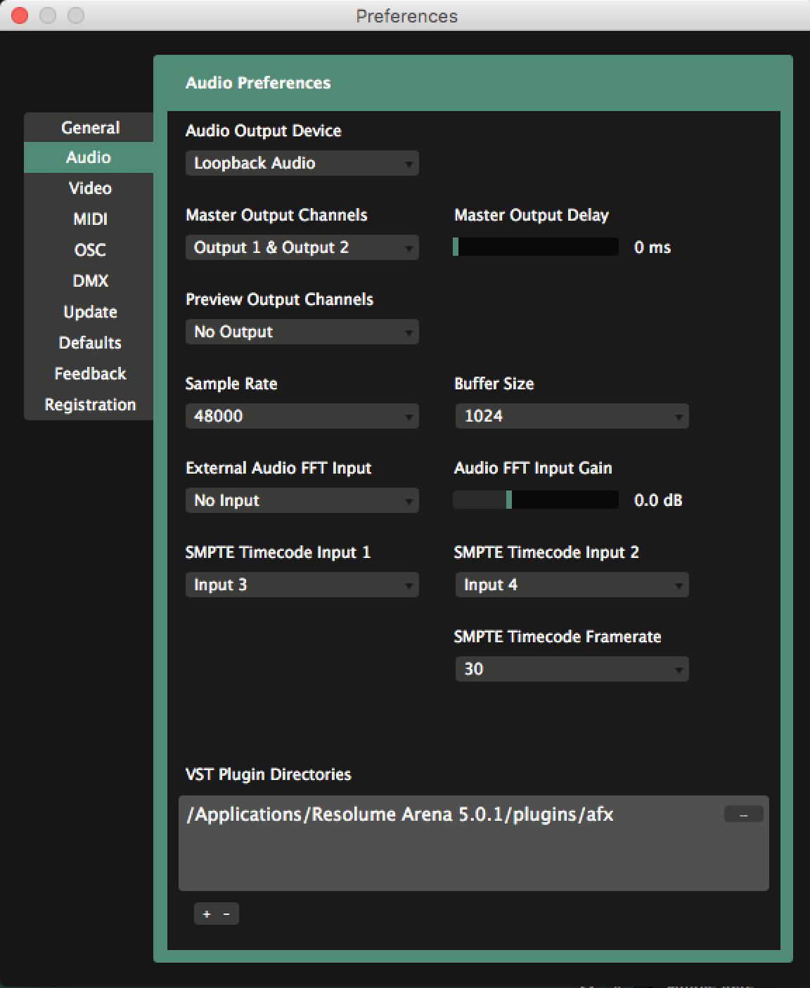

Arena can take two independent SMPTE timecodes
In Arena, choose channels 1 & 2 for audio input, channel 3 for SMPTE 1 and channel 4 for SMPTE 2

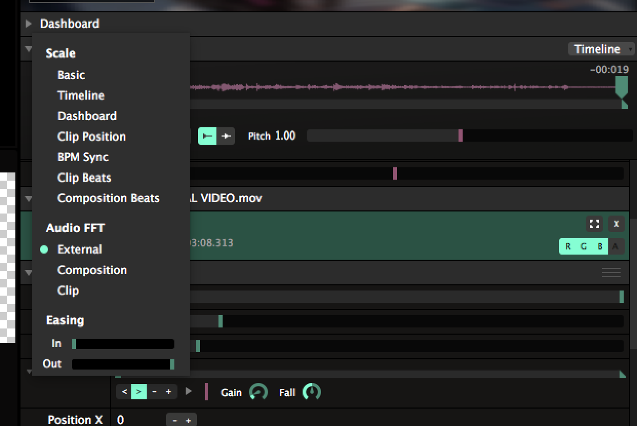

Then you would use channels 1 & 2 to animate a parameter. To do so, right click on the arrow next to the parameter name and select External Audio FFT.
Note that you could also setup channels 5 & 6 for preview but you get the idea!

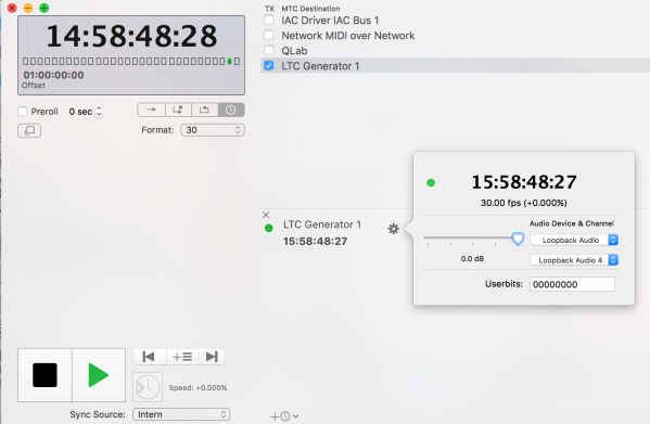

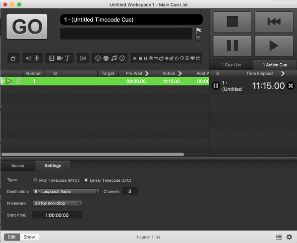

Horae and Qlab (pro audio or video) are both great timecode generator for the mac. As a note, Qlab can handle multiple streams of independent LTC and MTC timecode.

It doesn't generate it but it can play an SMPTE file since it's just audio. Here is a link where you can generate SMPTE timecode as Wave files.iTunes doesn't send SMPTE Timecode

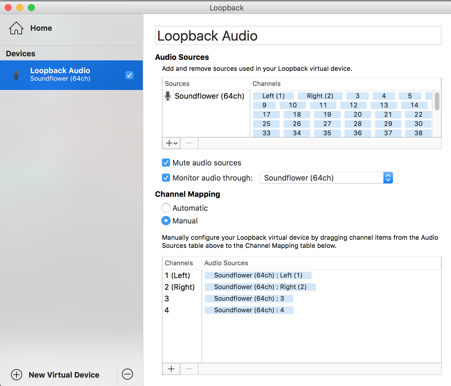

Oakton , I followed your pictorial guide to get iTunes playing through resolume-success when I switch by system preferences sound output to "loopback audio" But when I do this, music doesn't play through my interface/monitors anymore. Luckily I have audio hijack so I told the program to take input of "loopback audio" and run it through "mobile pre output"-sound started playing out of my monitors again.
