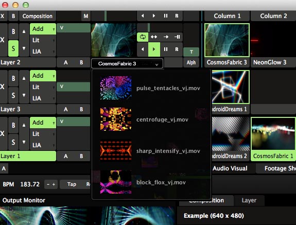

My 'undo-wish' is (was) merely focused on being able to go back into the triggered clip history per layer.
Maybe a 'redo former triggered clip - wish' would have been a better description.
In 2013 I submitted this dropdown menu request to access a clip history buffer viewtopic.php?f=6&t=10100 to describe what I meant.
I now understand that it is not possible to realise and will not refer to it again (apart from this time of course

No worries, Barthvis. Thanks for understanding.
