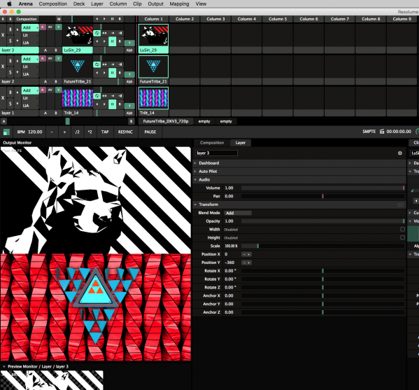

Apparently I'm old fashioned for using this technique, but I would just
- make my comp twice as high (1280x1440)
- position layer 1 and 2 in the bottom half (Position Y: 360)
- position layer 3 in the top half (Position Y: -360)
Then slice that up in the advanced output with just two slices, both set to comp input.
Bonus advantages:
- add as many layers as you want without needing extra slices
- your preview looks like your stage
- you can have another layer cover both screens, for instace to give both stage and DJ name a single background or overlay
