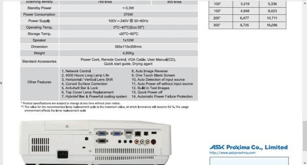

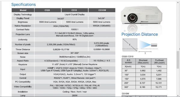

Please have a look at the attached Proxima C510W specs and advise if it is good enough to run video mapping at small/medium sized clubs. They are cheap and I want to try to buy at least four of them.

- - At 5,000 to 5,500 lumens the projector should be bright enough to get nice images up to about 10-12ft wide in environment with controlled lighting but you'll need to make sure you don't get too much bounce and that you have good projection surfaces.
- It has a high contrast ratio (5,000:1) so your black will be dark and your colors vibrant
- It has H/W lens shift so it'll be flexible (+/-10% H and +/-40% V)
- You can't change the lens so unless the 1.48~2.47:1 works for you, don't buy it!
- It has an HDMId port but no HDBaseT so if you need to send your signal from a farther than 15ft, you'll need to buy adapters
