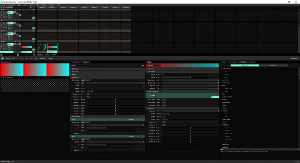

I dont know if this is the most efficient way to do this performance wise, but this works:
Note the 0.33 is actually 0.333333

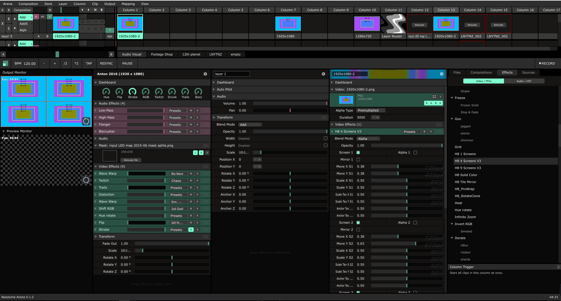

You can also just use the plugin i made, it duplicates the screen 4 times with paramters to use, I also have a pro version which does 9 screens. Let me know if you want it.
What system are you on, Win or OSX?
viewtopic.php?t=12818&p=52561#p52561

Re: 3 duplicate screen in composition?
Yaaa this is the method I was using on layer routers. I notice that depending on the content you'll notice one of the 3 screens come out brighter since there seems to be duplicated content overlapping on one of them. I was trying to use layer routers to cheat it to fix that issue. It does work on the layer level which is great. But the same ocd that noticed the resolution problem also noticed the bright screen and was driving me nuts. ><t13swift wrote:I dont know if this is the most efficient way to do this performance wise, but this works:
Maybe it can be shifted to do 3 instead or 4? I'd love to try it!hive8 wrote:You can also just use the plugin i made, it duplicates the screen 4 times with paramters to use, I also have a pro version which does 9 screens. Let me know if you want it.
Oh also win 10 x64 system.
Oh with the plugin you can do 1, 2, 3 or 4 pro version up to 9. You can turn them on or off, you don't have to use 4 or up to 9, its up to you how you configure it.
Also since it is a effect you can add it on the clip, layer or composition, and save presets.
Future version will also have a rotation and opacity slider per screen for even more control.
Follow the link in the post above, you can download it and try if you email me i can send it direct as well.
Send me a PM and i send my email.

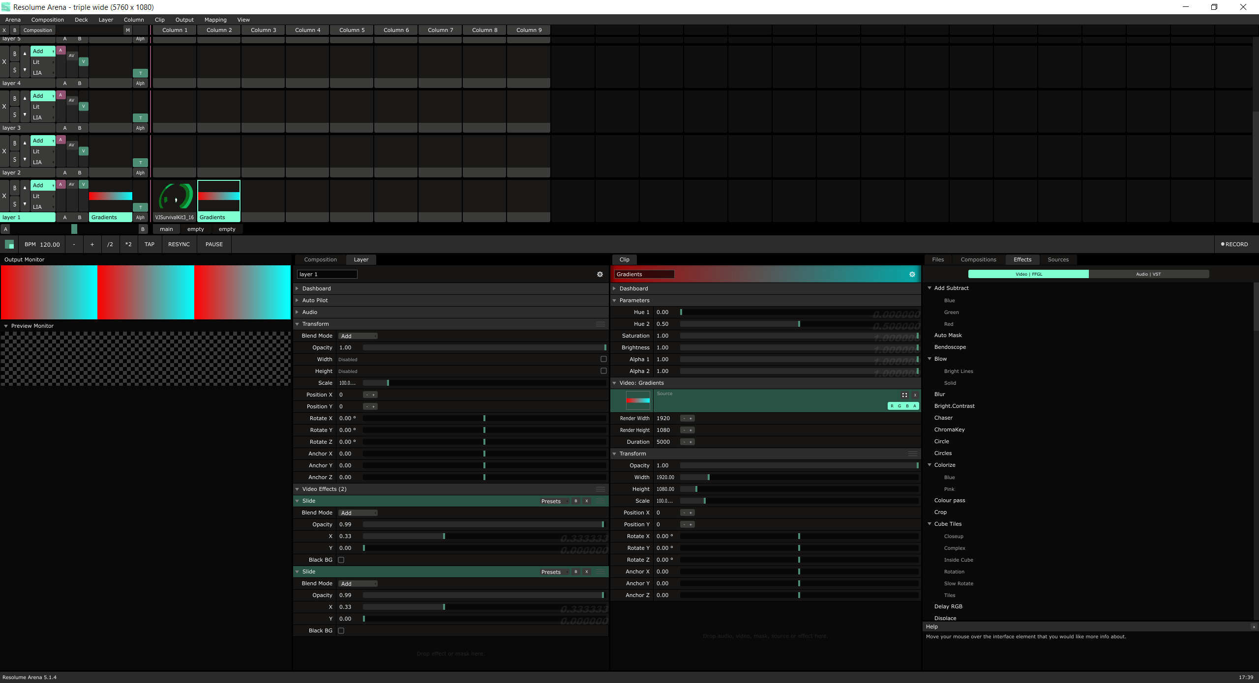

To Joris: I was able to get the tiling corrected with the transforms moved to the top. But the scale needs to still be set to 300% with the height transform activated and set to 350.00. Then the tile effect set to 0.05 on the x axis. Visually it seems to be correct but I don't know if there is a better setting.
I gave it a shot, and it seems very powerful. I had to do what Joris suggested still by moving the transforms up to the top above the effect stack otherwise it was still pixelated.hive8 wrote: Follow the link in the post above, you can download it and try if you email me i can send it direct as well.
I've only had luck with these settings:
Layer transforms
height (Checked on) 360.00
scale 300.00
middle screen
x 0.4999
y 0.5001
scale x 0.3333
scale y 1.0000
Left screen
x 0.3333
y 0.5001
scale x 0.3333
scale y 1.0000
Right screen
x 0.6666
y 0.5001
scale x 0.3333
scale y 1.0000
