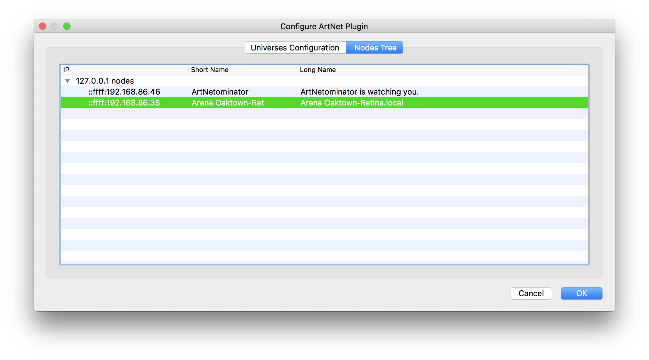

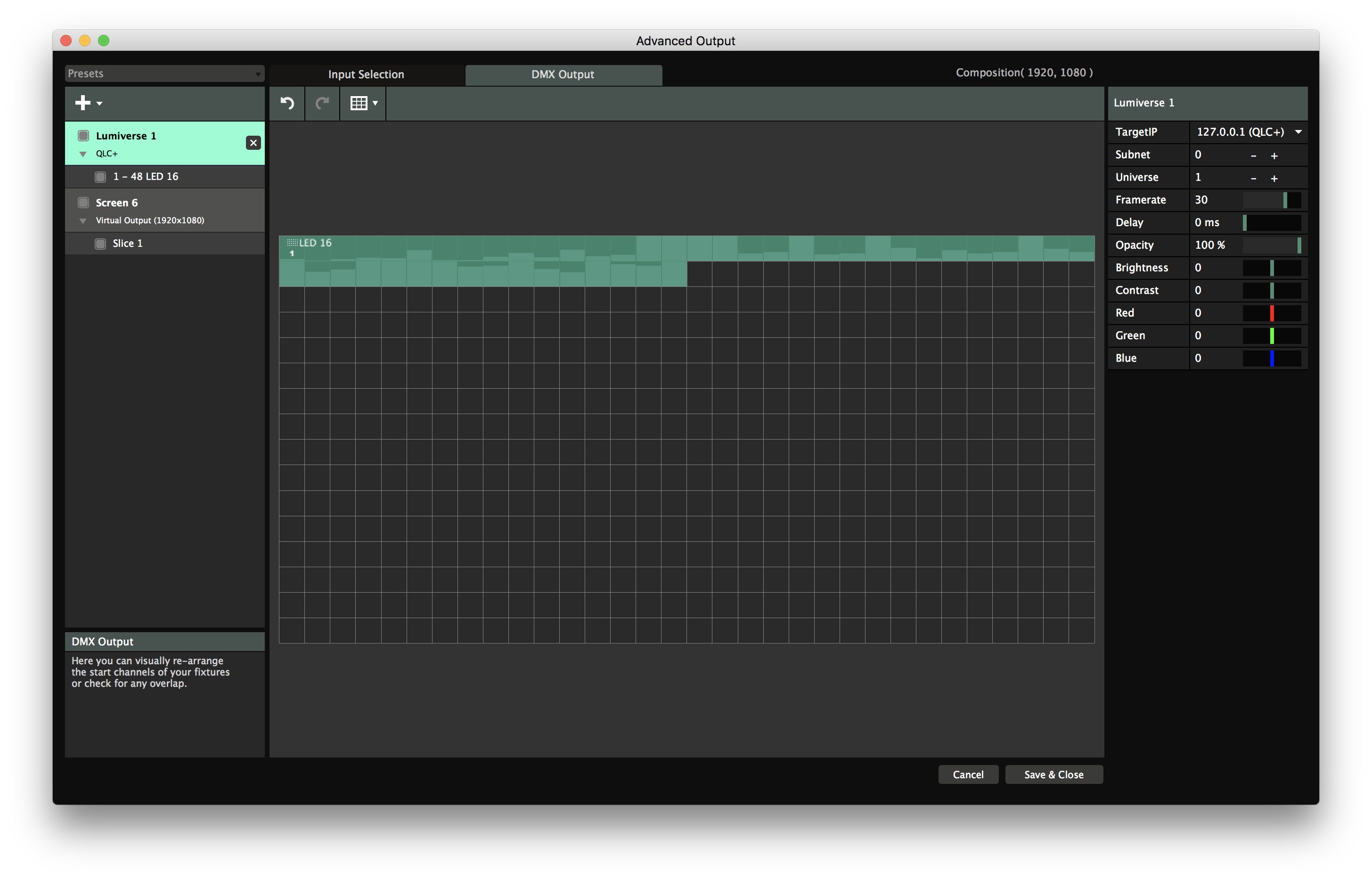

Re: Artnet: Resolume-QLC-vvvv The Bermuda Triangle?
An Arena 6, are you sure you didn't set your DMX input to the same universe as your lumiverse?
Can you send a screenshot of your Artnetominator window?
When you open QLC+ and set your input to 127.0.0.1, does it show up as targetIP in your Arena 6 lumiverse? And do you see Arena when you check the Nodes Tree in QLC+? See pics below.

In R6 I can't get it to work. Everything looks as you wrote, Oaktown: in Resolume there is IP "127.0.0.1 (QLC+)" and in QLC+ I see Resolume's node, but QLC+ doesn't receive anything.
