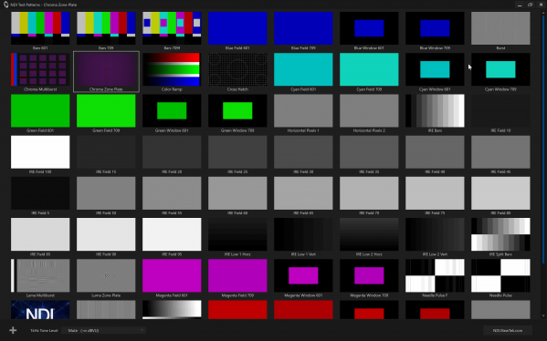

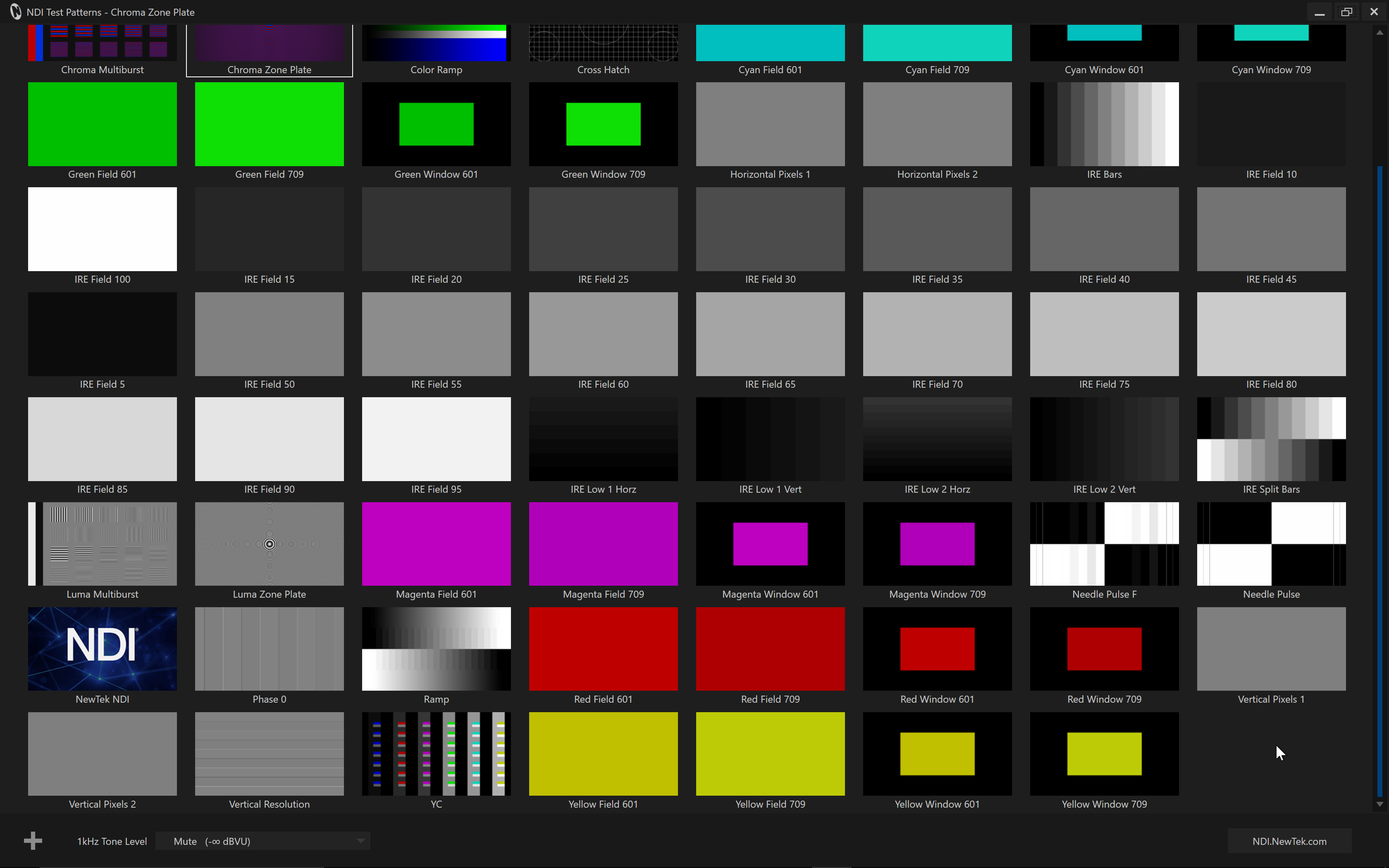

If you are on a PC, you could use NDI Test Pattern app which is part of the free NewTek NDI tool kit which gives access to a lot of various test patterns AND gives you the ability to add your own:
