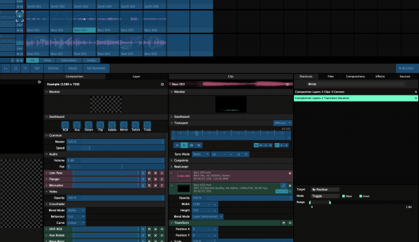

Hey folks,
i wonder if there is a way to piano tigger a clip with an infade of 0s and an outfade of 0,6s to achieve kind of pulsing effect like a decay.
thanks in advance

Can be done but you'll have to do quite some shortcut mapping if you want to trigger many clips this way.
have a look at this screenshot I mapped the A key to trigger a clip and at the same time it is mapped to the Layer's transition with end values.
when I push A, the clip starts without fadein, and on release the clip fades out in 1,84 seconds.
If you need more clips, duplicate the Transition time shortcut, (right click menu) assign a new key, and the same key to another clip launch in the same layer.
Should be the same procedure for midi notes.
