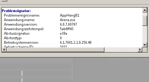

After the last Update i run into this Problem:
I Start Arena and all a look normal. But when i drop a Clip i only see this
Then i can click around but nothing happens. I need to "kill" Arena via the TaskManager.

- First Crash before reinstall etc... never saw this a 2cnd time.
- Resolume Crash.png (7.03 KiB) Viewed 14980 times

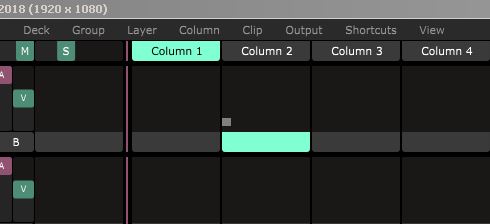

It's the same type of "crash" or freeze as t13swift describes it. After drag'n'dropping several videofiles it freezes in that kind that everything's still working except triggering clips. Last clip keeps importing (grey progress bar which stops). "Quit" doesn't work either, just nothing happens.
