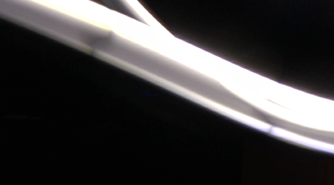

I use a video feedback in resolume to keep the traces of light done in space
When I use live input camera (comes from intensity shuttle) I have bad quality:

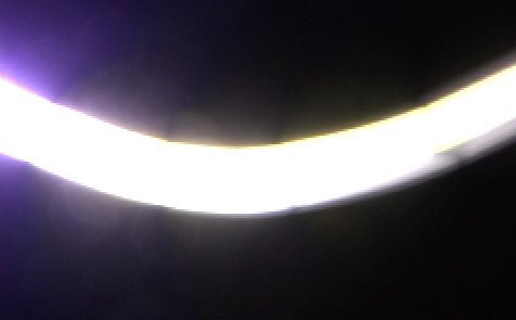

but when I use spout (comes from max/msp/jitter) I have good quality:
I have tried to adjust parameters in the graphic card settings and put the same max/msp/jitter but quality doesn't changed.
is there a reason that the video feedback effect can affect the quality of the video ?

Try switching off De-interlace in the Blackmagic clip
Gildas
Joined: Tue Oct 02, 2018 22:59
Re: Live camera input quality
Post by Gildas »
Nice ! It's that !
Thank you Zoltán !
