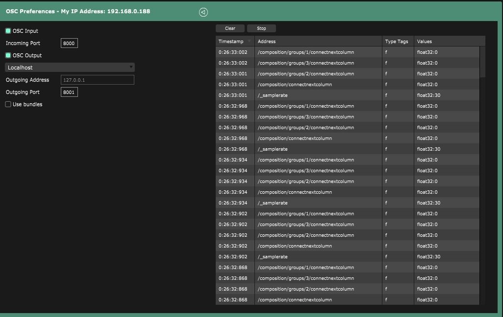

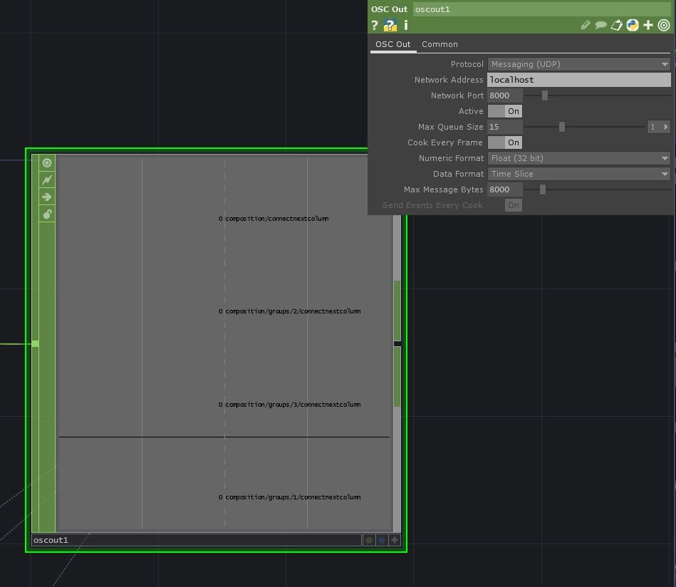

tried to recreate it at home on my desktop ,crashed when tried to switch from untitled basic comp to a saved comp. Did get the crash reporter , filled it in , here are the touchdesigner settings .
It's caused by the touchdesigner patch i uploaded to my topic in the developers forum

Also looks like you're flooding it with spam. can you turn off the cook's for each sample or frame and only push out osc when changes occur?
