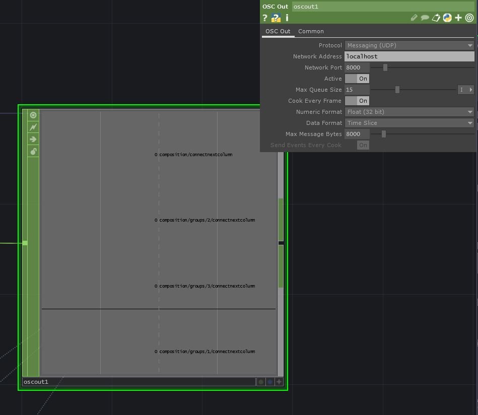

I've made a autoplayer patch in touchdesigner , sending OSC commands to various groups or layers for next & previous column or clip.
If i start resolume 6 while touchdesigner is running and the OSC-out node's is active , it will crash resolume immediately before it's fully opened, every time , whatever comp resolume is running.
I switch off the active parameters in touchs osc out and it opens , where after i can activate it again in touch and resolume is happy listening to the osc.
Unless i open up the OSC output , then it might be wobbly again so i got conditioned to turn osc output off in touchdesigner before i do that..

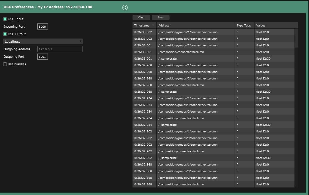

What messages are you sending exactly and at what rate?

tried to recreate it at home on my desktop ,crashed when tried to switch from untitled basic comp to a saved comp. Did get the crash reporter , filled it in , here are the touchdesigner settings .
It's caused by the touchdesigner patch i uploaded to my topic in the developers forum

Yay its fixed in the beta
Re: Touchdesigner OSC crash
Also looks like you're flooding it with spam. can you turn off the cook's for each sample or frame and only push out osc when changes occur?
Grimm90
Posts: 277
Post by Grimm90 »
jup still a lot to learn there
