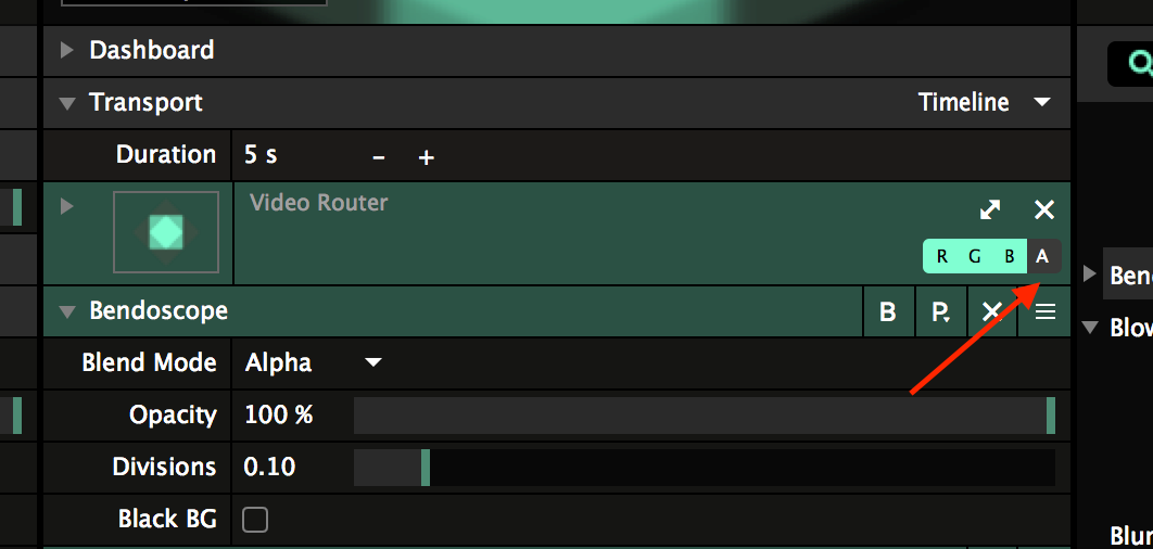

Sounds like your layers below might have transparent areas.
To get rid of these and have your video router clip be displayed hiding the layers below, turn up the Layer's opacity all the way,
then switch off the Alpha channel in the Effect clip's properties:
