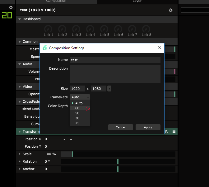

I have seen numerous threads regarding this issue but haven't had any luck. I'm running a GTX1070 and can't get more than 60fps on a blank composition. GPU power is set to max performance and V-sync is on. There is no option to disable Optimus as far as I can tell.
Does anyone have a solution to this?

The monitor is not the issue as I still float around 55 frames on a blank composition with no output connected. Unfortunately turning off V-sync is not an option as it results in tearing. Low FPS seems to be a common issue with NVIDIA cards, is there no other solution?

just to clear this out....you will never be able get more that 60 fps with v-sync enabled + 60hz monitor/projector or even without any physical output attached when your notebook-screen is set to 60hz.
My problem is that at best I get 55fps with V-sync on, even when locked to 60. When I connect an output (60hz) I'll barely get 30 frames.
