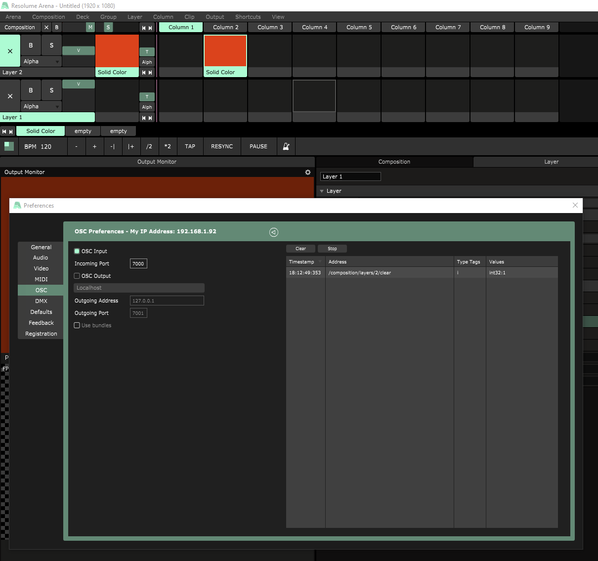

Bug report :
When receiving the following string from an external OSC controller :
composition/layers/x/clear
- Any playing clips on the layer 'x' will not clear
- In the UI, the layer 'clear' button gets stuck in 'mouse down' state (ie:permanently highlighted).
Clicking on the 'clear' button with a mouse works fine.
Once the button gets stuck upon receiving the above OSC string, I can 'un-stick' it by clicking with a mouse.
This holds true regardles whether I start with a new composition or use a well populated one.
This exact scenario has worked fine for me for sereral years with all flavours of Arena and Avenue v 4, 5 and 6.
I just upgraded to Arena 7.
I found this issue in v7.1.0 rev67353, which was the first v7 build I run.
<update>
Arena 7.0.5 rev67117 running on a completely different machine also has the exact same problem.
Whilst it may sound like a benign thing, it's a massive headache for me.
I run several instances of Resolume 24/7 as commercial installations in unattended mode, driven by external OSC sequencers.
My extensive OSC programming would now be largely broken and I'd be forced to amend tonnes of code to introduce a junky workaround (triggering an empty clip slot on the same layer to clear any playing clips).
Please HELP !

We have a ticket for this.
Try sending layer clear message with int 1 to clear layer, and then again with int 0 to release the button.

That works, thank you, Zoltán !
To mimick the 'mouse down' and 'mouse up' events I redefined my 'layer clear' cue definition.
I now send two OSC strings interleaved with a tiny delay, like so :
<cue id="Layer X Clear" >
<osc address="/composition/layers/x/clear" value="1" />
<osc address="/composition/layers/x/clear" value="0" delay="10" />
</cue>
I will still need to update a lot of code to make my sequencer schedules to work.
Luckily for me, they are stored in XML and not encapsulated into a binary format.
At least it'll be a global 'Find & Replace' job.
Whilst doing all this is a lot less junky than triggering empty clip slots to clear a layer, this still remains a (hopefully temporary) workaround.
Like I said previously - just sending the 'composition/layers/x/clear' OSC with int value of 1 works as expected with previous Resolume versions.
When you can, please fix the v7 to behave the same way.
