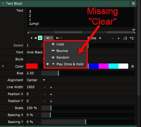

So I played a bunch with using Text Block as a count down when it came out. Now I want to do more with it and I noticed something missing. You can't seem to do a proper BPM triggered layers in the same way that you can do Time based layers.
10
9
8
7...
Counts down. Just set your play length in Seconds and it will jump to each layer, each second. But if I try to do BPM playback
3
2
1
Jump
and set to 1 beat, it just plays "Jump". Even if I set to 4 beats length (one beat for each layer), I just get 1 and then Jump.

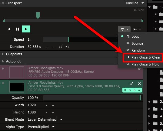

The other issue I see is that the Text Block source does not allow for "Play Once & Clear". The Clear option is totally missing and only allows Play once & Hold. That is not really consistent, as this is the only place I see play once and clear missing. At first, I thought it was because I was using BPM. But even Timeline playback is missing this option.
Normal clip / timeline play
Thoughts?

A parameter timeline is different from a clip timeline.The other issue I see is that the Text Block source does not allow for "Play Once & Clear". The Clear option is totally missing and only allows Play once & Hold.
You can't clear or eject a parameter.
I think you're looking for the clip transport settings. Indeed the Sources and Still images don't have the playback controls. We have a ticket to make these also available for these types of clips. Then you 'd be able to have a text source play for 5 seconds and then eject.
This, you can kinda do already, by placing a blank source after your Text Block, and enabling auto pilot to next clip on the text block.
