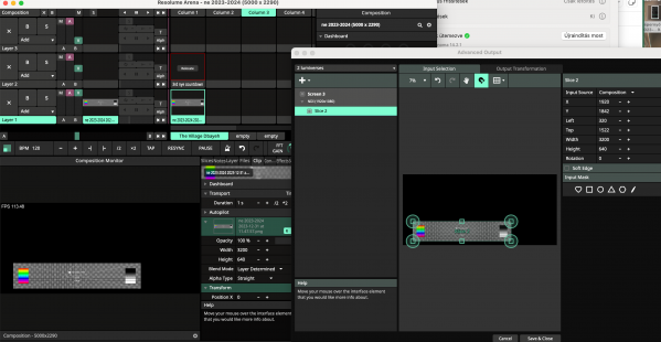

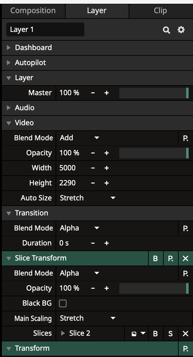

Posts: 7803
Re: Slice transform scaling issue
Works just fine for me with these settings, layer at composition size.
We're working on some improvements for the slice transform which should help with your case.
