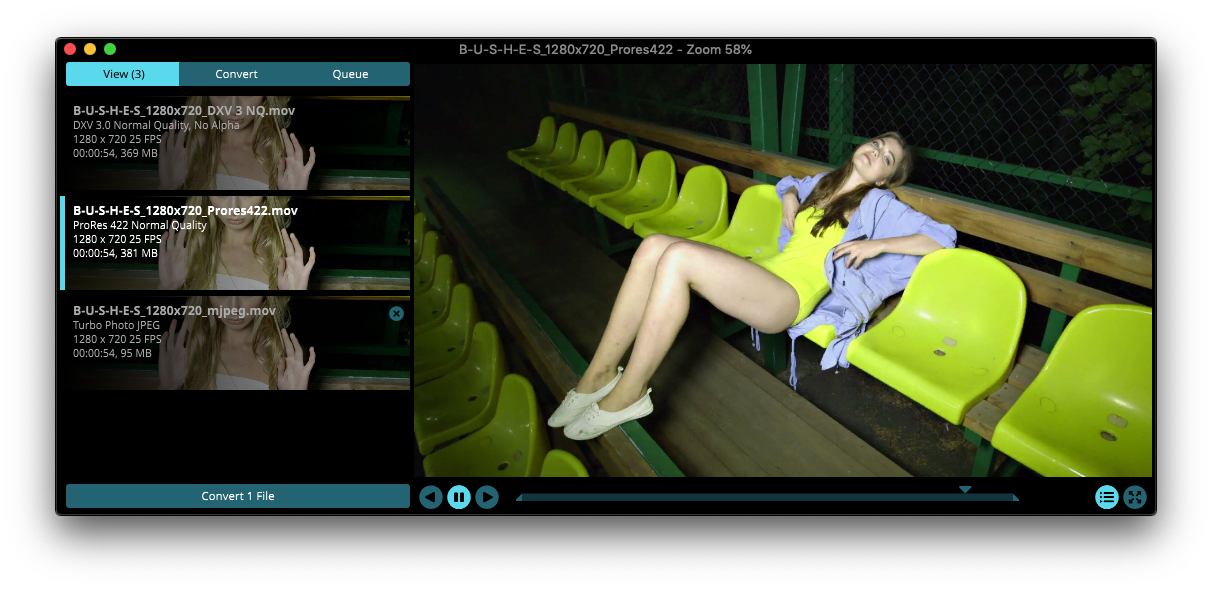

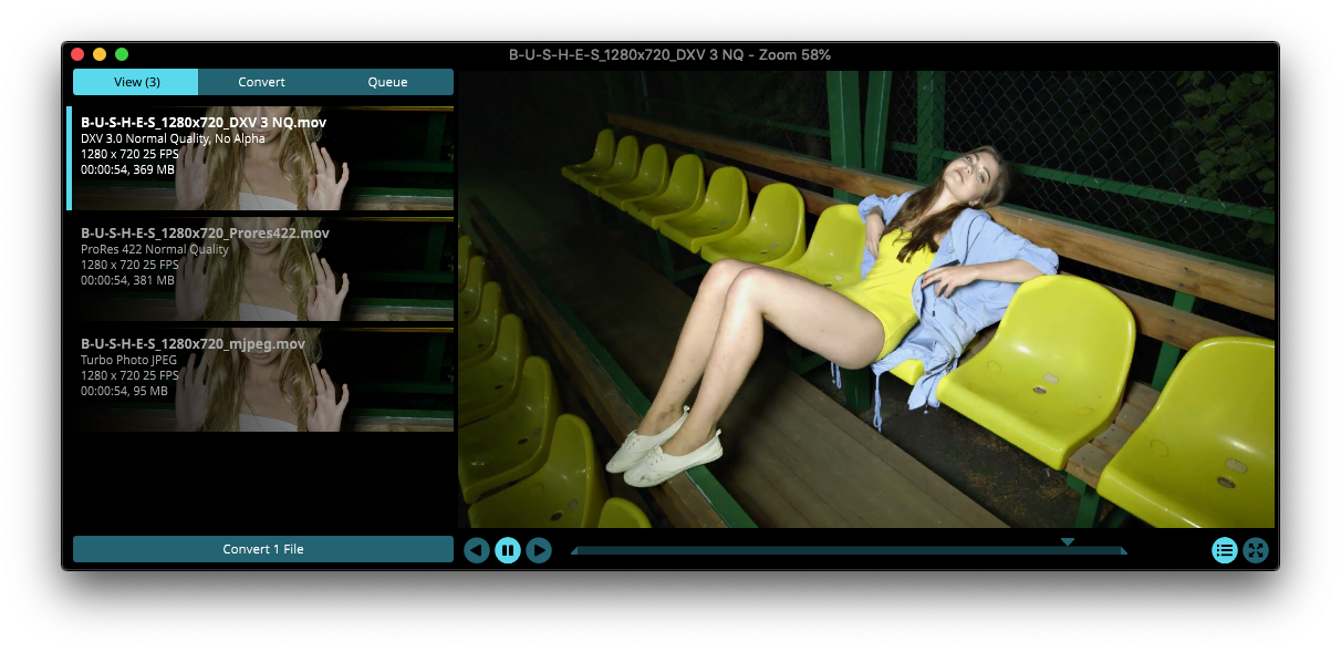

I've noticed a shift to green when converted a dxv clip to prores using Alley, and then previewing with it.
DXV source
ProRes 422 converted

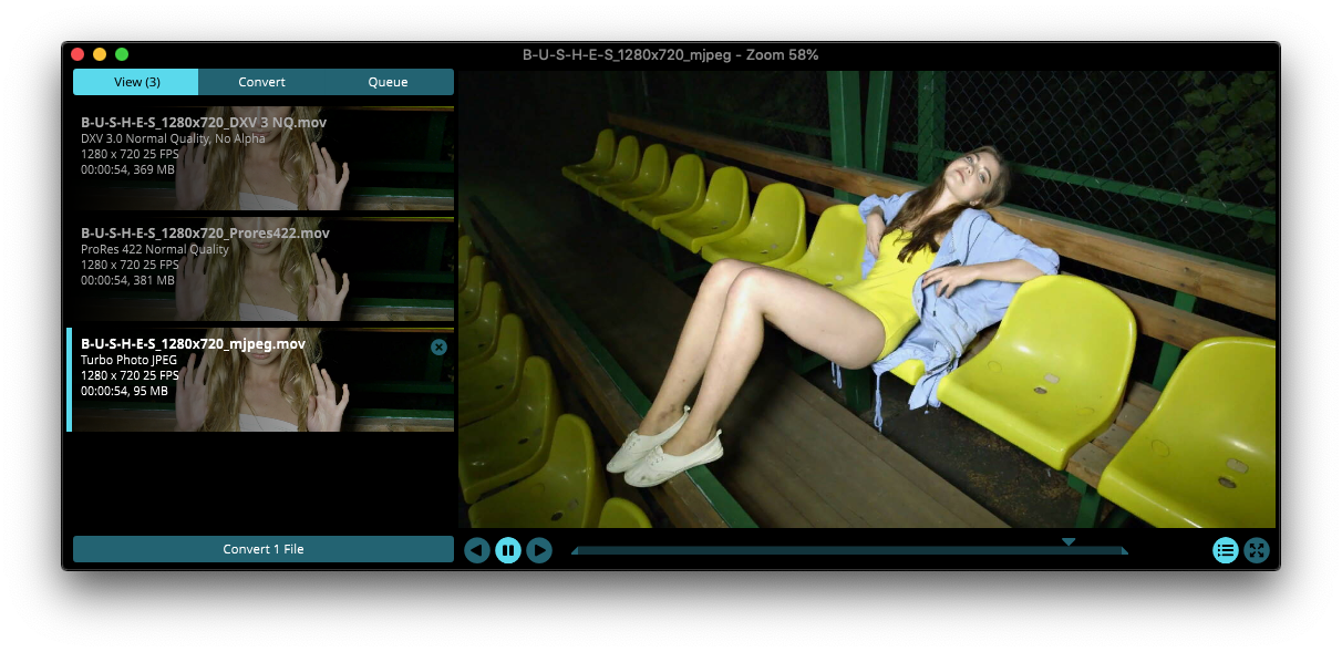

Mjpeg converted
Not happening when clip is converted to Mjpeg.

Alley - DXV to Prores = Hue shift
