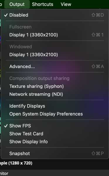

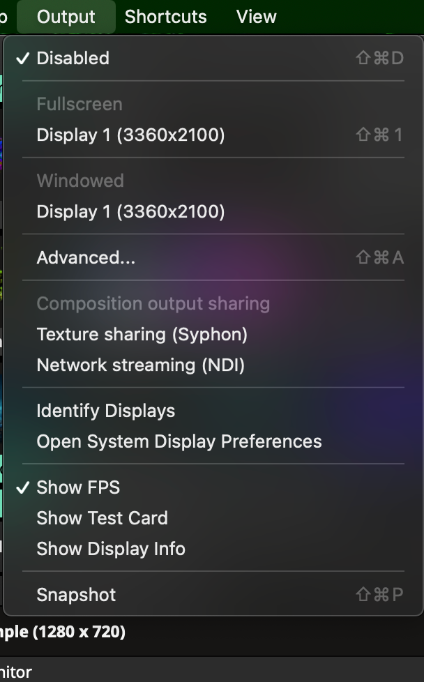

When I came back to my studio, Resolume now show my built-in display is 3360x2100, even with the System Preferences showing the built-in display 1650x1080. If I lower the resolution, I always get some extra pixels ONLY ON Resolume.

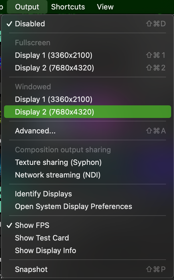

When I connect an extra 4K Monitor, the things get even worse, Resolume shows the Display 2 as 7680x4320 (screen shots annexed)

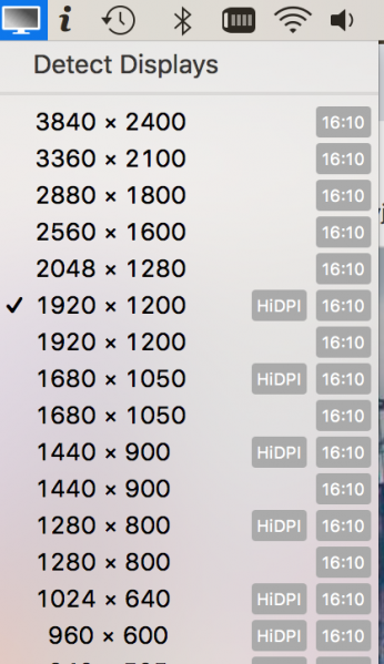

Some of these resolutions might be a HiDPI resolution.
OSX uses these to do scaling of the UI elements, but it will still show you images or video at the display's native resolution.
SwitchresX can tell you if the resolutions available are HiDPI
Here, for example I have 2x 1920x1200 resolutions for my built in display which is native 2880x1800
For best Results on the output, make sure your output display is set to a non HiDpi Resolution, so running at a natively supported resolution.
(very similarly to Windows, where the display scaling should be 100%)
