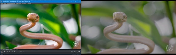

Is there way to convert hdr video with alley?
On the left - how MPC play this video, on the right - Alley.
Alley HDR video

I downloaded this from youtube.
https://youtu.be/LXb3EKWsInQ
Though my display can't reproduce HDR video, MPC uses LUT to convert it from HDR to Rec.709 colorspace (I think), so I see bright colors even on non-hdr display.

Re: Alley HDR video
Resolume does support 16bpc processing, which is not exactly HDR per se, but has the scope for processing HDR-like content.
