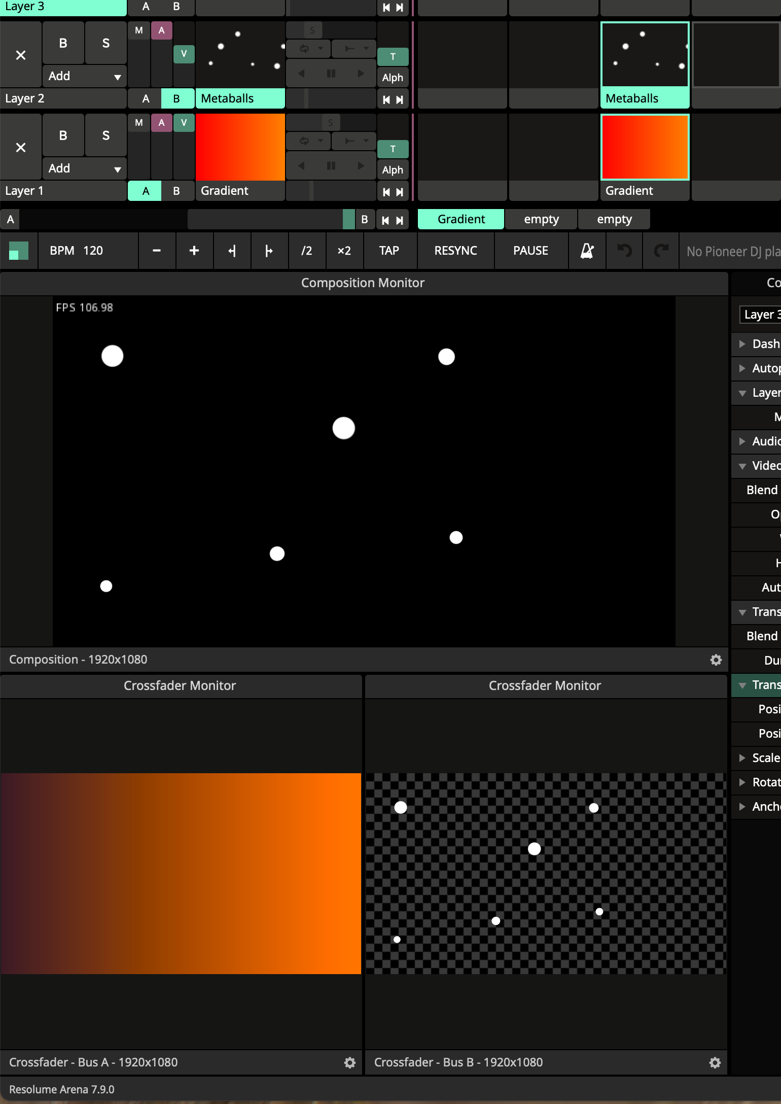

When you have the preview for the A/B bus up it goes to black if you are on the other buss on the crossfader. Ie A preview is black if the cropssfader is on bus B I get the crossfader result should do that.. But the A/B preview should not fade so you can preview what you are building.

Hmm, works fine for me.
Could you post a screenshot of the Resolume window?

Groups break the A/B bus preview.
I got it to work without groups but with groups the preview goes black.
Posts: 7483
Re: A/B preview
Groups are special case for crossfader.
Each group has it's own crossfader behind the scenes, and these will get combined with the composition crossfader later.
A group's layers only can see what's going on inside a group, as do the group crossfaders.
For now the Crossfader bus preview only shows the composition level.
