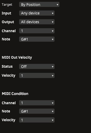

But I would implement it differently: I wouldn't make a new button for it as it would be confusing, dedicated and weird. I'd make it a MIDI shortcut feature: For every shortcut you could also set a condition – channel, note and velocity, which the note needs to be at for the shortcut to be active. If the condition is not met, the shortcut won't do anything. This would enable us to set the same MIDI button in two shortcuts with different conditions – here one for trigger (note D7 at 0) and one for preview (note D7 at 1). It would be super versatile and could be used for much more - think of buttons for cuepoints which could be set with SHIFT (D7) + button and recalled with button only etc. I'm adding an image of how this could be implemented in the UI.
We actually do have this feature with keyboard shortcuts, where it is possible to assign shortcuts like SHIFT + A, but sadly this is not currently possible with MIDI shortcuts

But how do you do that? I think that most controllers can't. I'm using the recommended AKAI APC40 Mk2 and I think there isn't even any software at all, if I haven't missed anything.Arvol wrote: Mon Feb 14, 2022 05:19 and then mapping one of your buttons (in your controllers software) to be a switch/shift is the way to do this.
I also own Behringer X-Touch Compact for my lightning setup – it's software can remap buttons but there is no switch/shift feature. And the last one I have is Korg nanoKONTROL Studio for sound control, which does have editor software, but can only define scenes and it's pain to switch between them – definitely not usable for shift. I don't know anything about other controllers...
What controller do you use, which's software can do more advanced features like this? I think Resolume should handle the shift/condition check. And I think that most other pieces of software (like music DAWs) handle things like shift, banks and encoder modes themselves too, so controller manufacturers don't bother implementing those...
