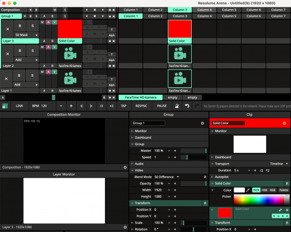

Could you attach a few screenshots of how you have the clips set up?
Playing a capture source on layer1, and having the same on layer 2 in a group masked by a white solid color, group set to 50Difference blend I get no difference signal, so both the masked group and the straight capture clip are the same.
Luma mask sounds like you might be using an external effect?
