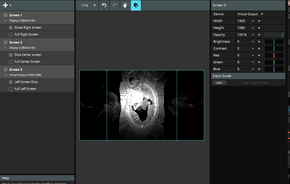

Hello, new to resolume here and liking it so far and tryin to figure out how it all works! for now i have 3 4k led tvs that im running. i have left in (2160x3840) portrait, (3840x2160) middle in landscape and (2160x3840) right portrait. What do you all suggest for the best setup for the output?
In resolume Ave i made my comp 3840x2160
In Output Advanced, I made 3 screens and sized the slice to 3840x2160 in the order as listed above. I then grabbed all 3 slices and sized them proportion to the 34840x2160 then adjusted the middle to the 2160 as seen in pic.
Using Resolume Avenue

Depends on what you'd like to do, how should your tv-s look like?

As mentioned above 3 led TVs .... the two outside ones will be in portrait and the center one will be landscape

You want some overlapp? you want some "virtuell" distance to make it most realistic (like watching through 3 windows) or what do you wanna do ;)
Either way you will lose some parts of you composition area when you dont want stretched or compressed ugly stuff ;)
so max high (3840) x max wide (2160 + 3840 + 2160) is the max pxle you native will need.
so depends on the content you can scale that down a little

Note: what i did was add 2160+3840+2160 =8160 for the width
and 3840 for the height of my comp.
Based on what i have read and some videos i watched.
