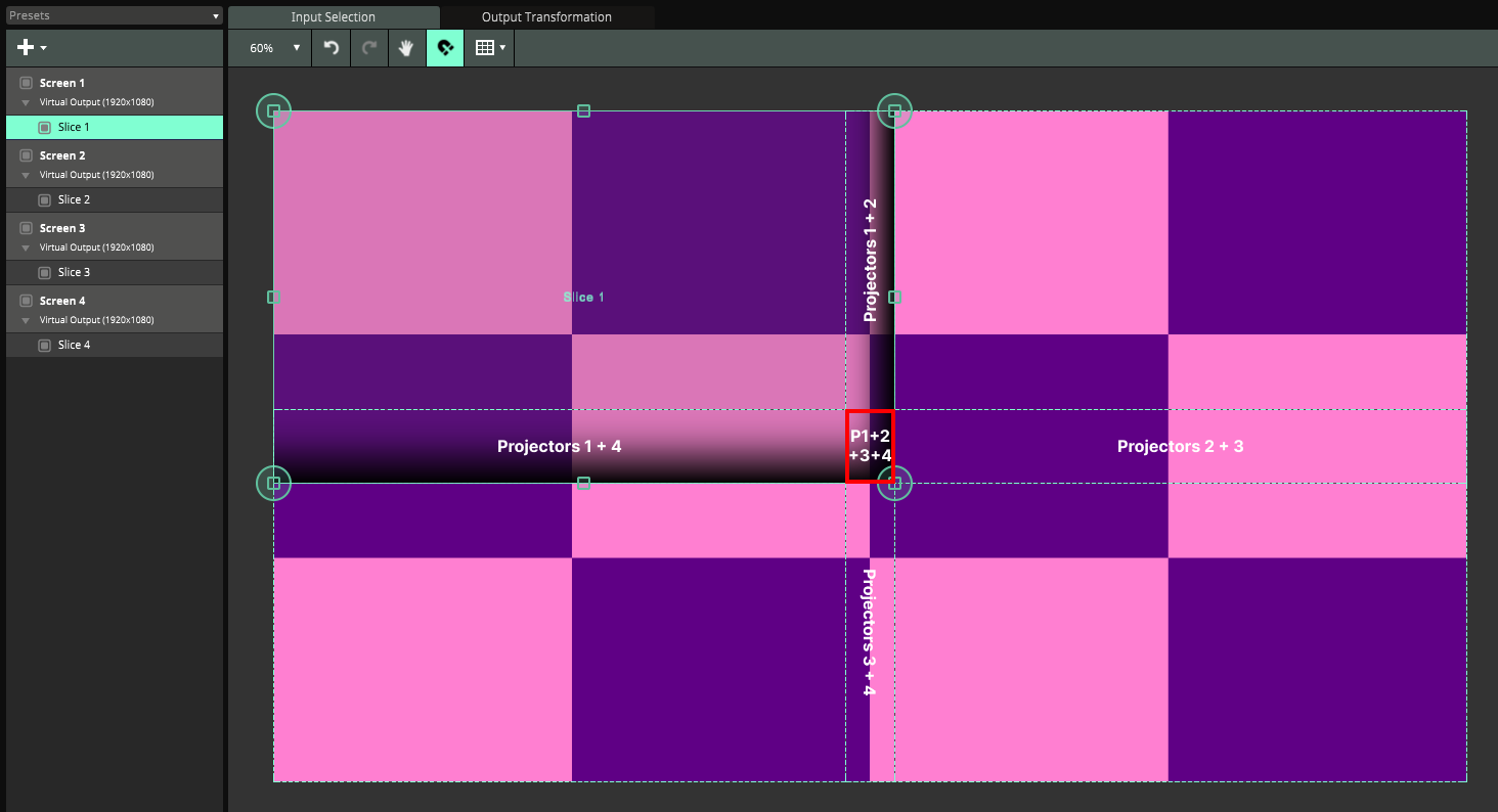

Hey everyone,
I have a Soft Edge interrogation: in short, is this kind of 2x2 projectors setup possible with Resolume?
advanced output with 4 blended slices
More specifically, I'm wondering about the brightness of the zone I've circled in red, where all 4 projections overlap. I understand that Resolume calculates the soft edge automatically based on the overlap but does it take into account the fact that there are four slices in this spot?
If not, should I mask this zone in two of the slices so that it becomes a blending between only two projectors?
I've worked with edge blending before, but only with 3 projectors set side by side so I only needed to blend each on 1 dimension. I don't have the projectors at the moment so I can't check the result right now but I'd like to know beforehand and all the video resources I've found so far only show 1-dimension blending.
I hope my question is clear enough, thanks in advance!
Léa
Posts: 7668
Re: Question about Soft Edge with 4 projectors
leaaaa wrote: Thu Feb 15, 2024 20:10 Resolume calculates the soft edge automatically based on the overlap but does it take into account the fact that there are four slices in this spot?
Yes, it does.

Zoltán wrote: Fri Feb 16, 2024 19:47
Yes, it does.
