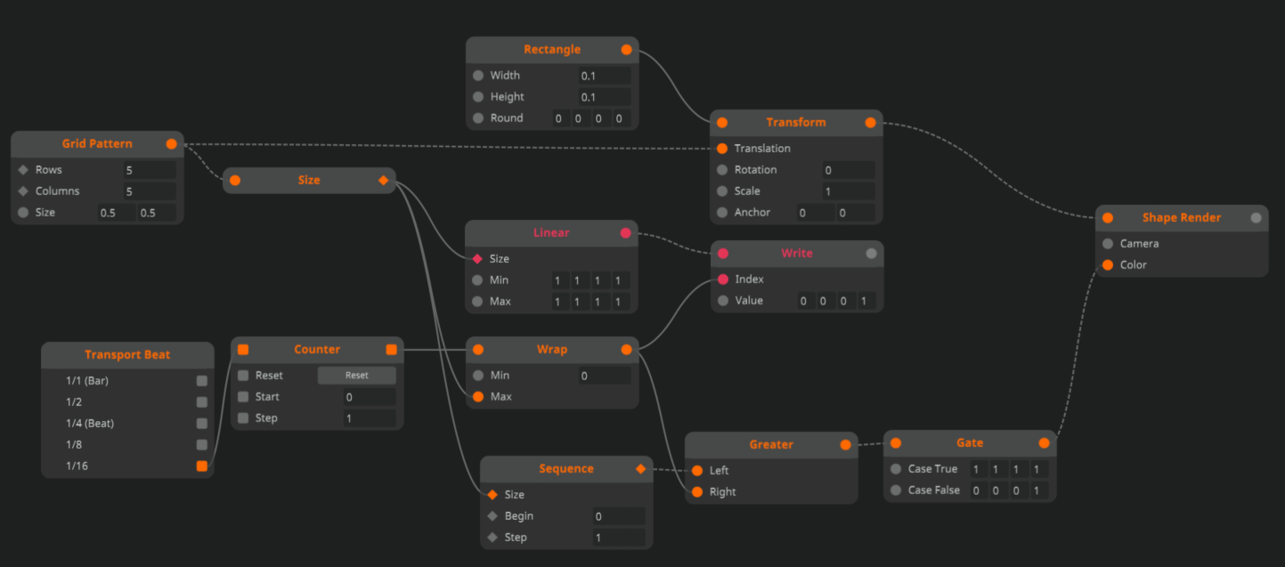

Hi, I have a grid of squares in which I am changing the color of one of the squares in sequence on the beat i.e. square 1 then square 2, etc, and then back to one. This probably isn't the best way to do it but it works.
1) Is there a simpler way of doing this?
2) How can I get it to cumulatively change the color i.e. 1 then 1,2 and 1,2,3

For your first question - you could use the wrap node between the counter and the write to make things easier:
Second question, this could look something like that for example:
