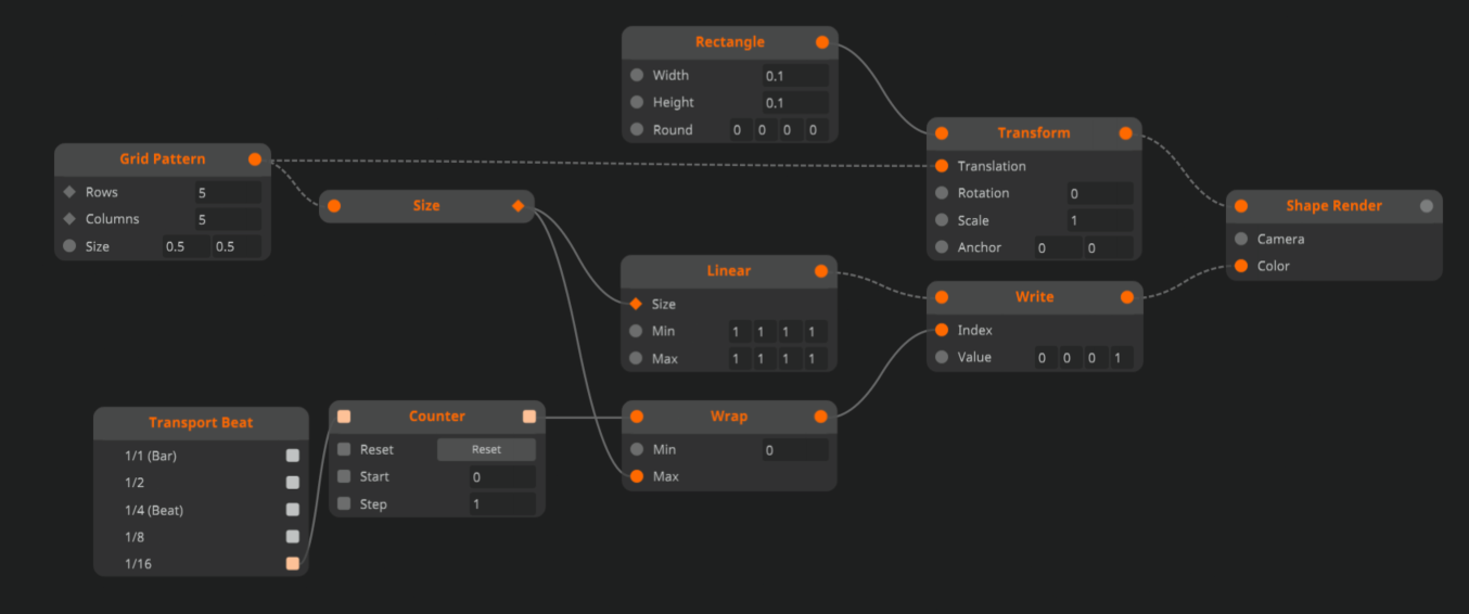

For your first question - you could use the wrap node between the counter and the write to make things easier:

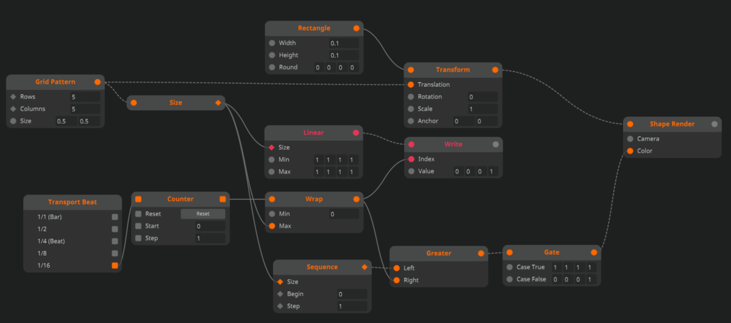

Second question, this could look something like that for example:
