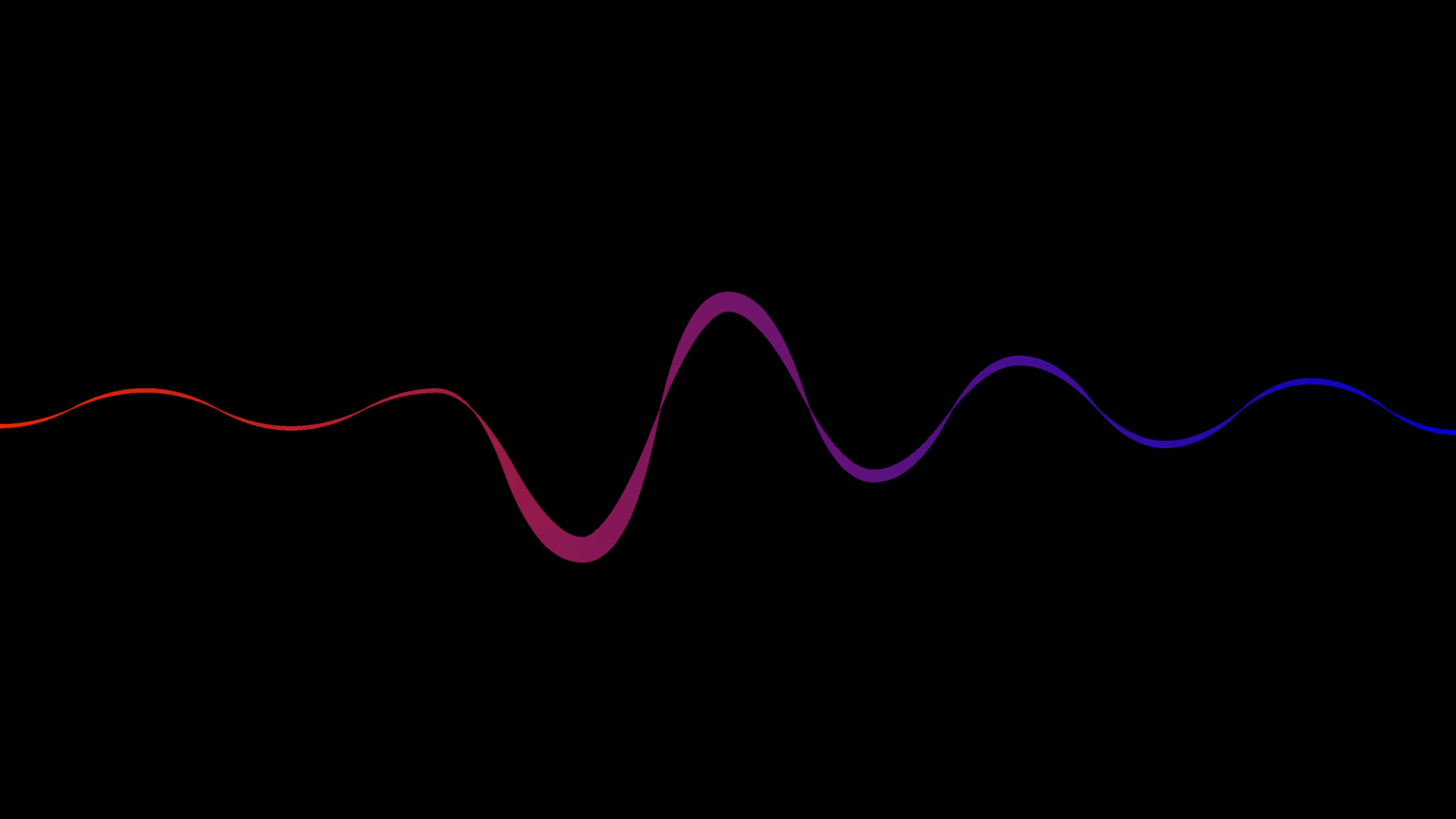

This is a pretty simple line that dances around in response to the FFT. It's part of a bigger thing I'm working on that I decided to break off into its own patch, but I like some of the effects I can get running multiple instances layered over top of eachother. Thought someone might find it useful.

moldybeats wrote: Wed Sep 11, 2024 03:21 This is a pretty simple line that dances around in response to the FFT. It's part of a bigger thing I'm working on that I decided to break off into its own patch, but I like some of the effects I can get running multiple instances layered over top of eachother. Thought someone might find it useful.
Thank you mutch for sharing it, I DL & testing it, but the pict looks cool
