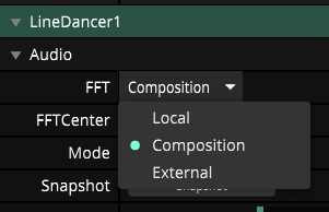

It didn't work for me in Wire or Arena (after compiling) other FFT reactive things work fine in Arena.
Am I doing something wrong in wire? > Version 7.22.3

In Wire this currently won't show any movement because there is no audio input.
In Arena you have to select the correct FFT source in the clip-panel, if you select 'Composition' there needs to be some audio playing in your composition, for 'Local' there needs to be an audio clip on your clip with that patch and for 'External' you need to have an external audio FFT source set up in the audio preferences.
Screenshot 2025-01-30 113350.png (14.16 KiB) Viewed 24461 times

It seems that I compiled it as an effect, and it worked fine when compiled as source
