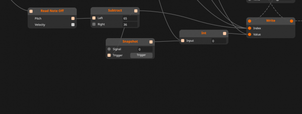

Do you get a 0 velocity for the note offs?
Notes coming in at the exact same time though, within a single render pass, the later one will take precedence.
Write in signal is sampling at frame rate, note events can come in any time.

still no luck, I'm sure the midi or OSC sends notes off / 0's.
To much note off are not triggering the video which makes ti unresponsive, here is my patch maybe you have some suggestions for improvements
