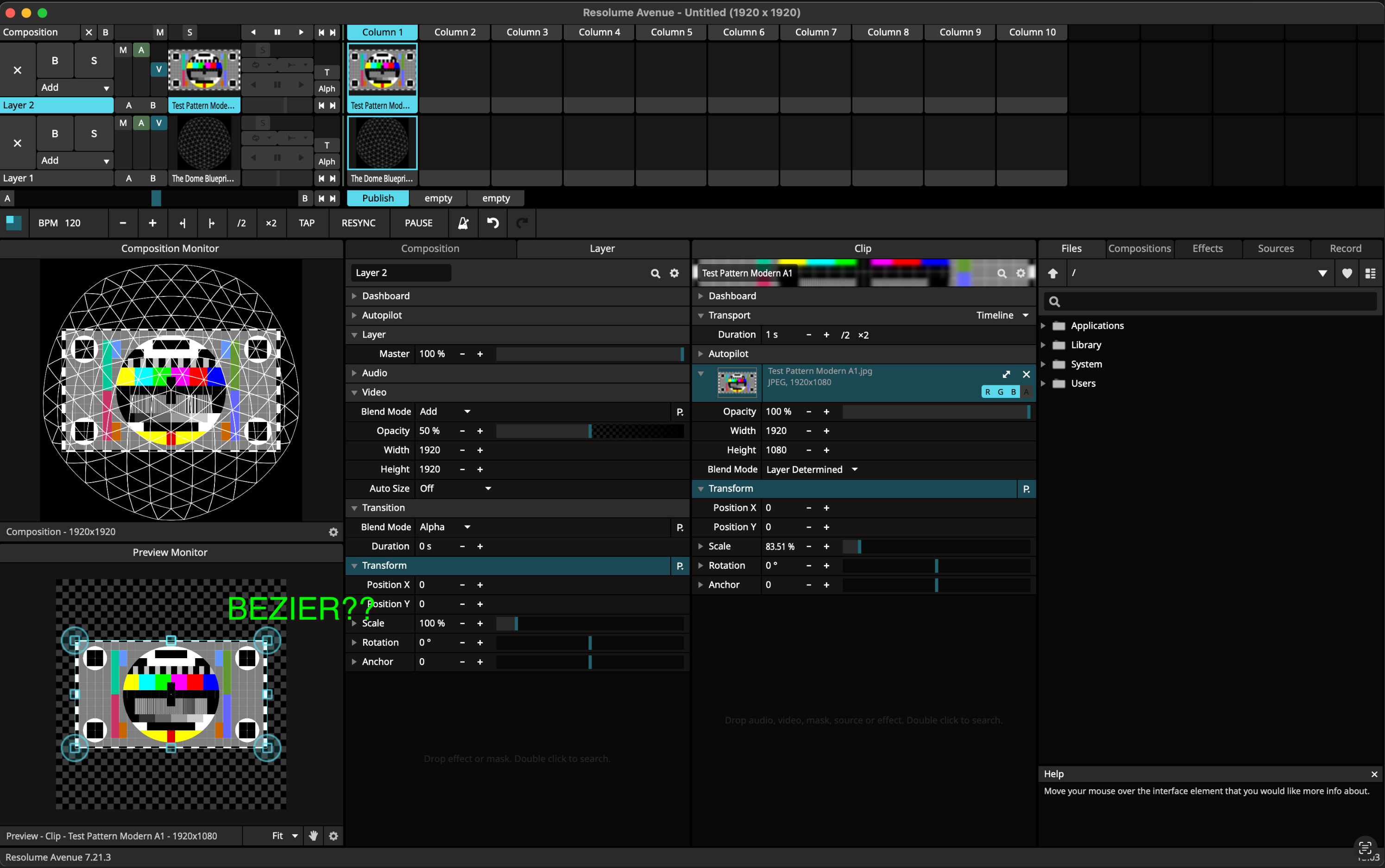

Working on a dome project and the idea is to feature a live video input onto the dome. Sort of a "Picture-in-Picture" effect.
For a dome the live video needs to be warped via a bezier transform to look correct on the final output.
My question is can Resolume Avenue transform a single clip or layer to be a bezier curve transform?

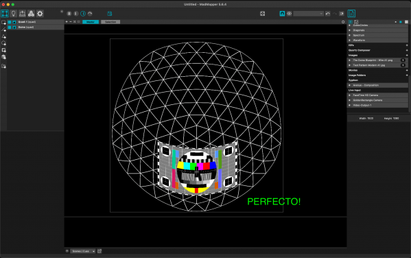

Please see screenshots of my very simple setup in Resolume. The 2nd screenshot shows what I would like it to look like but it is in MadMapper.
Ideally this transformation could be done in Resolume so that MadMapper can be purely the calibration file and all the mixing and composition would be done in Resolume.
Is this possible in Resolume Avenue? I tried most of the effects but could not find an solution that would produce a bezier effect.
I see in the monitor on the lower left that the layer / clip now has transformation handles. If these could be bezier we would be good to go but I did not find a way.
Or, do we need Arena or something?

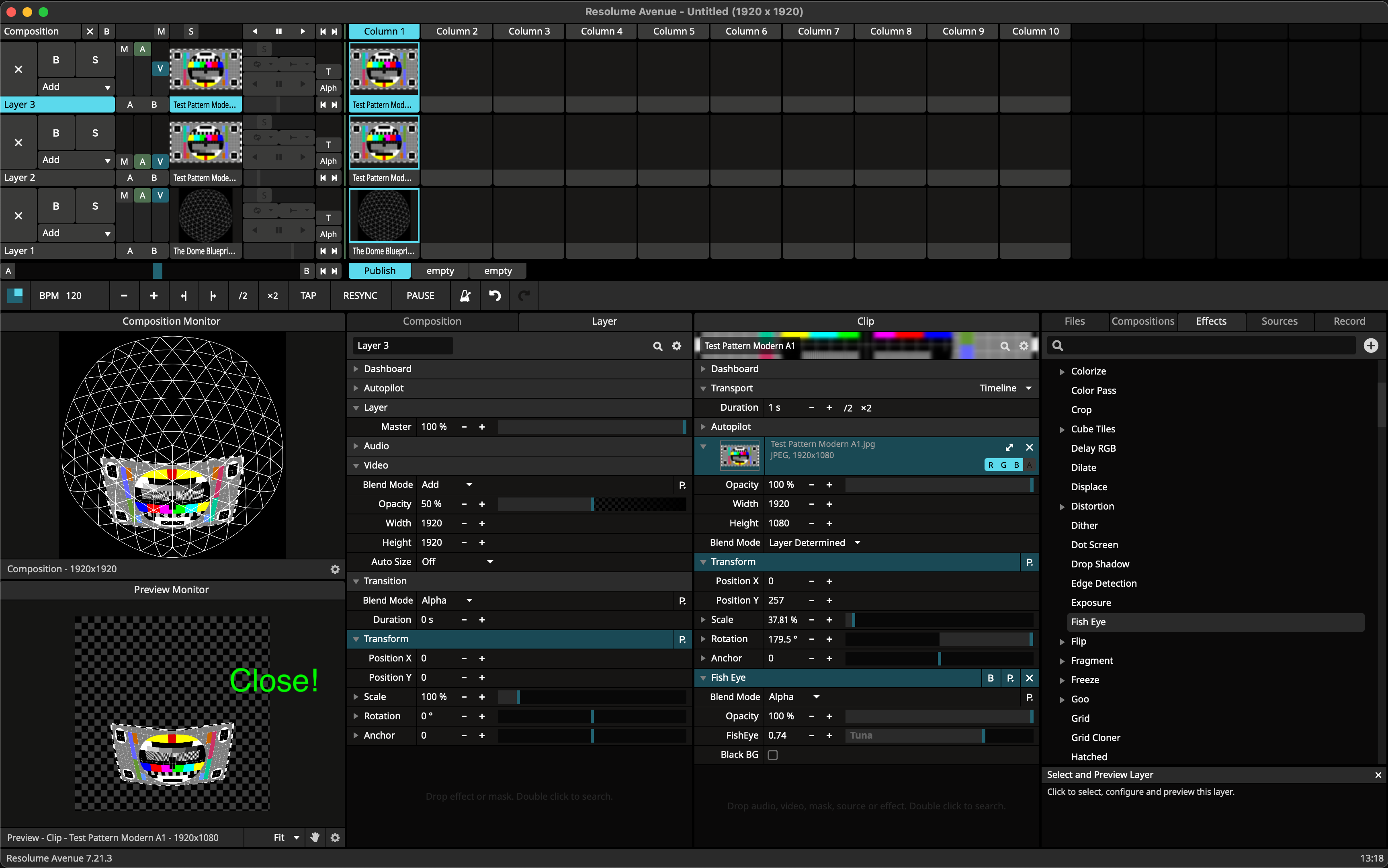

After a little more playing around the Fisheye effects gets super close but ultimately lacks the control needed.
I also took a look through the Juice Bar as well but did not find anything.
Any idea if Wire will do what we need?

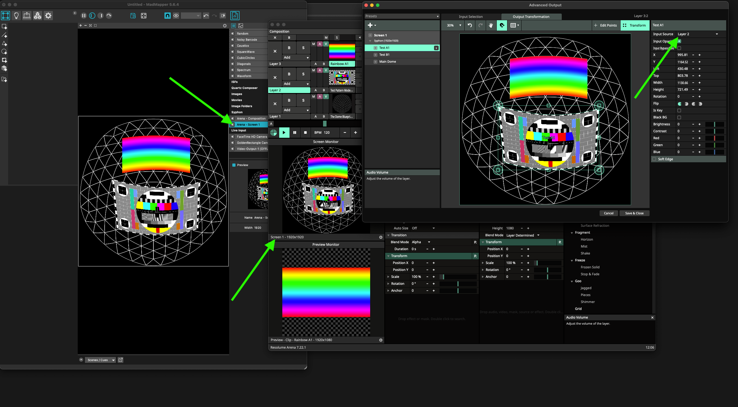

You can get bezier handles in Advanced Output, but only with Arena, not with Avenue.
The transform widget in the preview monitor won't give you bezier curves.

Okay great it looks like Arena is the way to go!
I was able to get this to work after a few minutes of tinkering.
The key take away was that the Advanced Output needed to be applied to individual layers and not the whole composition.
Then, the Advanced Output needed to be routed to Syphon.
Further, the preview monitor needed to be looking at the custom output and not just the general composition.
Then in MadMapper the input needs to be the Screen 1 and not the general composition.
In the full context this will mean a few more layers than normal but it will work.
I will be testing this further over the coming days to ensure flawless victory before pushing to production.
